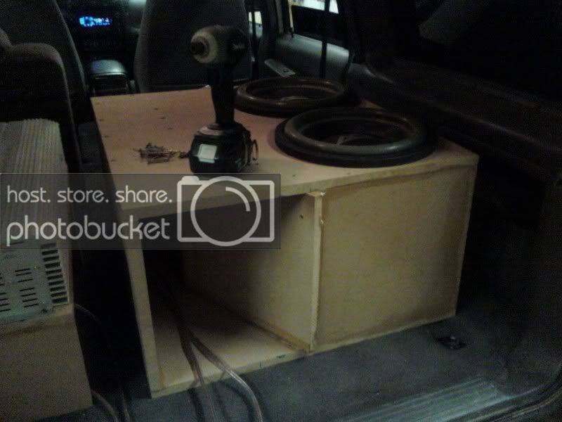

I think this might be the box I will build... (sub firing up)

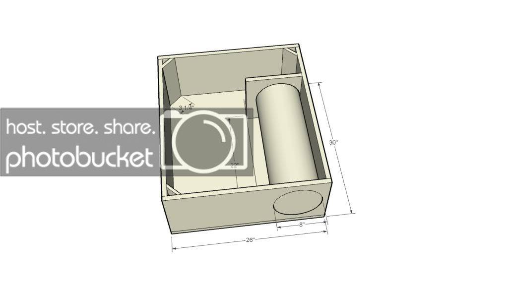

or possibly this...
the problem Im running into is that Im afraid that if I mount it on top of the second baffle is that the surround will hit the cover over the rear hatch space. I would just take the cover off, but I may be going to college in atlanta next year and I dont want people to see my stuff. If the double baffle doesnt make too much of a difference or if flush mounting it diminishes the advantages of the double baffle, I was just going to do one.

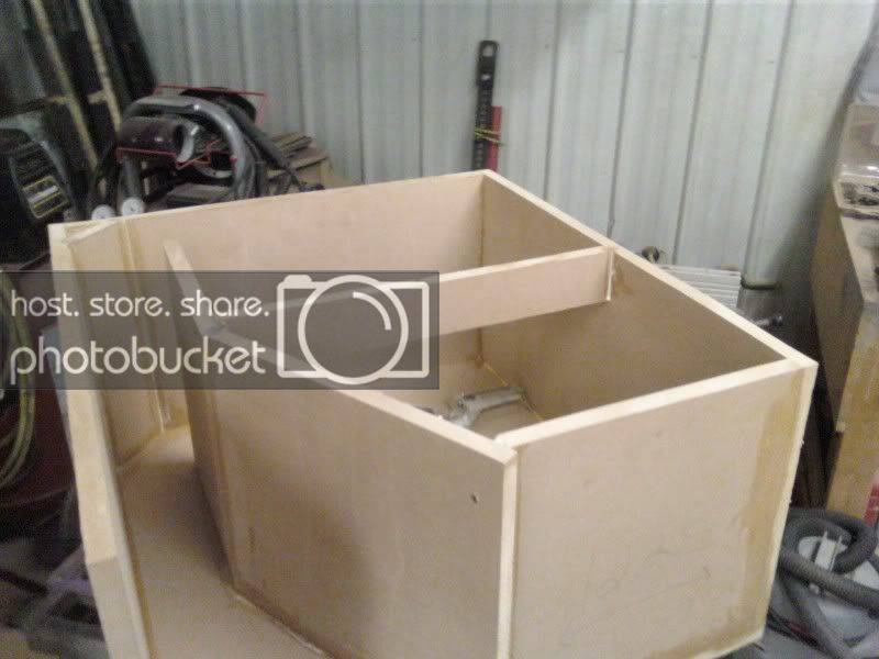

a brace like this is what i used on my last box:
i would had gone double baffle but i didnt have the wood. as for the subs ripping out of a single baffle. when i am careful its fine, otherwise just use t-nuts. threaded rod is also an option.
