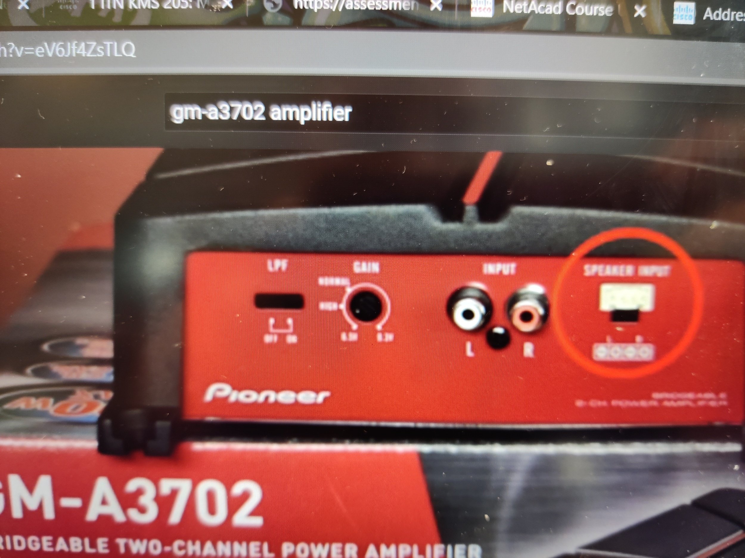

Thank you for your reply, the proneer amplifier also has an speaker input (see picture), could i wlso connect those to my head unit or do i NEED to use the rca cables with an LC2I LOC?
28082
You can use that as well. One thing I noticed is that the cheap LOCs and the built in Hi Inputs work well with OEM units that are not amplified or have very little features. The reason is that low feature OEMs do not protect the speakers so they play unaltered signal. In your case, I think you may have an altered signal because of the high end radio. Try it out, if it works, awesome. If not, you just add an LOC/DSP in the mix.
