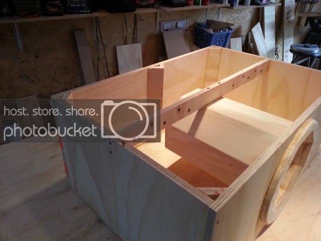

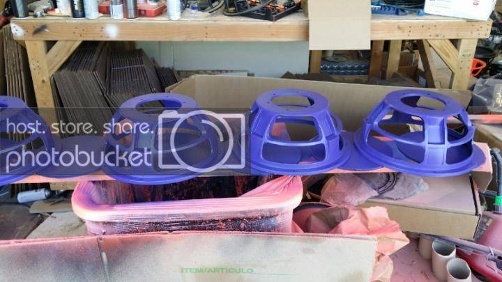

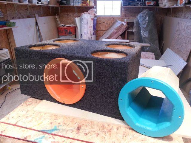

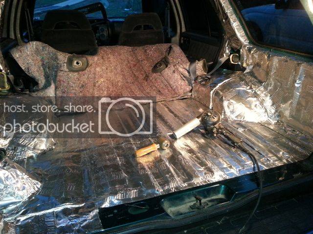

I don't get on this site much anymore but I am still messing around with a few enclosures...I had to slow myself way down...I thought I would share a few pics of my personal little demo vehicle..I started out with four AB XFL 12s and two DC 3.5s strapped in the same style enclosure it currently has...At the moment I have two DD M4s strapped on four Tantric HD 12s in a 6.25cf net octo port enclosure tuned to 33hz along with PRV powered by PPI......We will be at SCRAPIN THE COAST this year if anyone wants a demo...

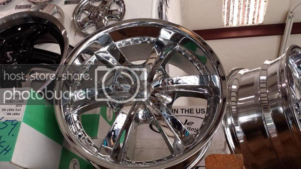

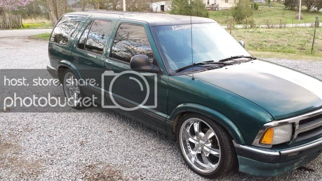

I have it lowered 3/4 with dropped spindles and springs sitting on 20s but I keeps em clean...LMAO......Waiting on my guy to have time to do my C notches in the rear......
