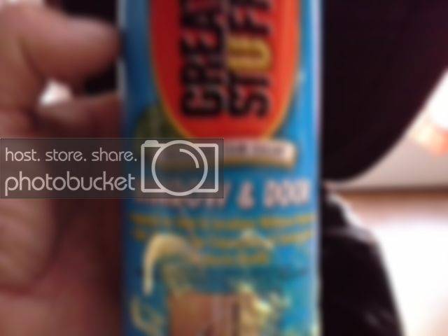

Says "DOOR" right on the label. $4.

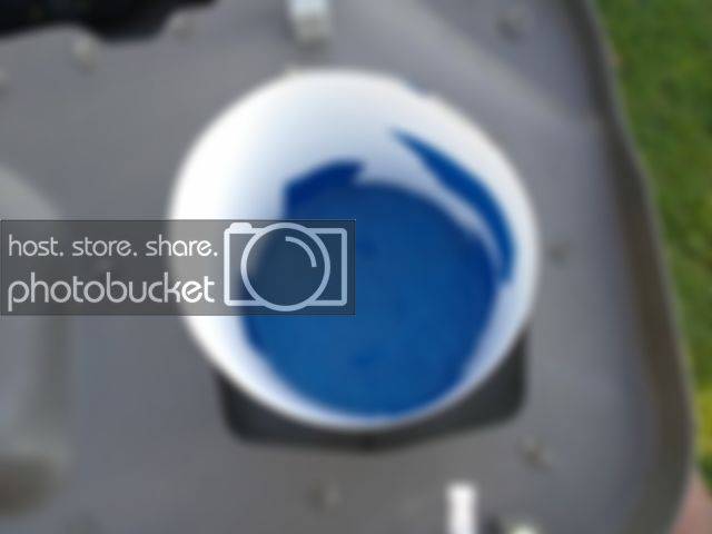

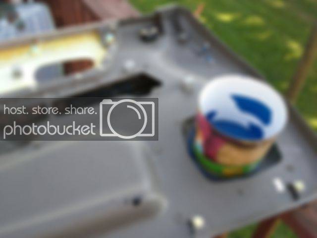

Made a ring out of scraps from the recycle bin and painter's tape. Didn't want all that goo poking through the grille.

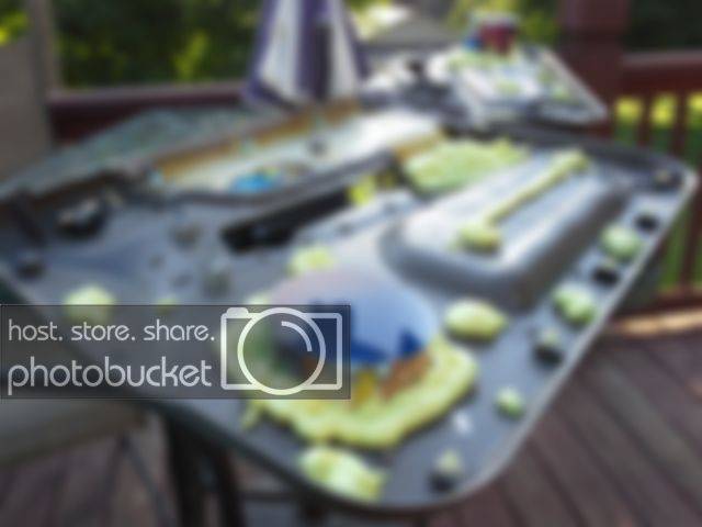

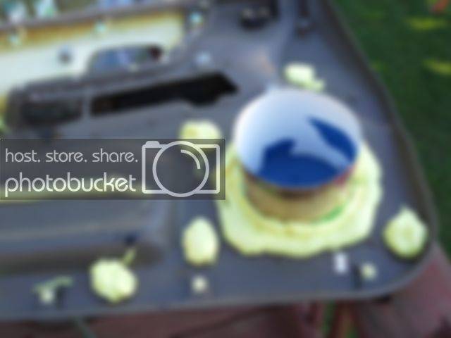

Foamed. I didn't spray way back in the cavity otherwise it would come out between the main door trim piece and the loosely attached (with plastic welds) front grille.
Added a few spots of foam here and there for vibrations. Say howdy to Jessie.

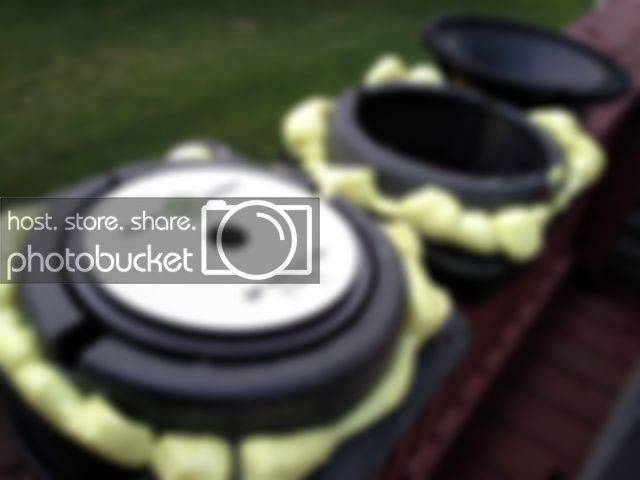

Also hit the door pods. These seem oversized compared to the last 6.5s

you'll need the rear of the cone to play into the door. from the pic above, it looks like it's almost sealed to the magnet and that will choke the woofer.
I wondered about that. Whenever I get the replacement speakers back from SoundQubed ( >>This Thread ) I will do some more cutting.
BTW, that great stuff doesn't stick to the plastic. When I removed the panels to send the speakers back, several dollups fell right off.
