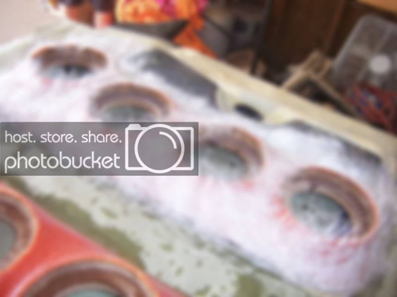

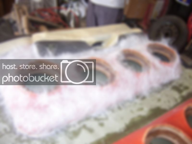

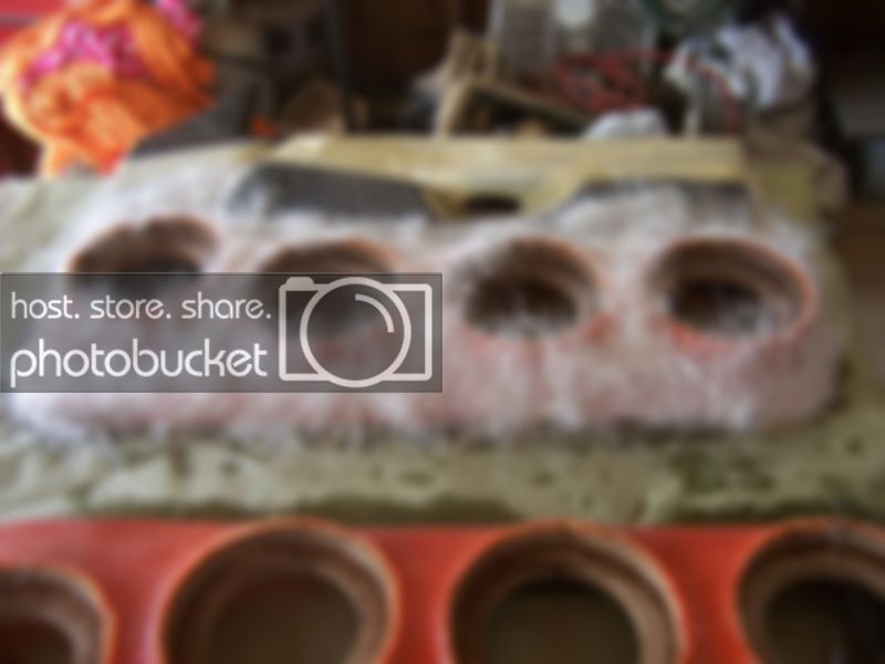

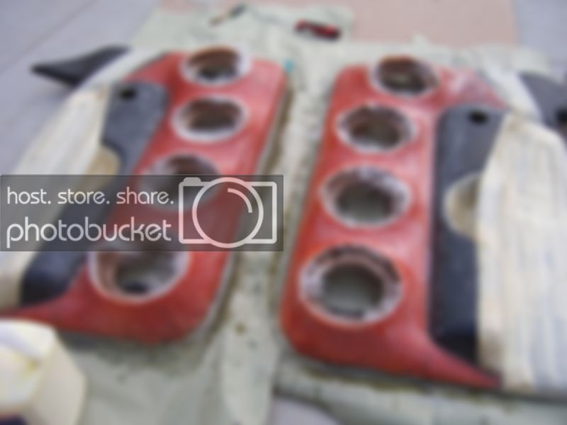

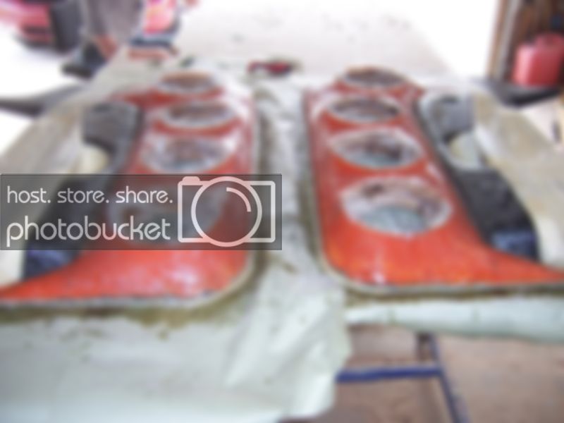

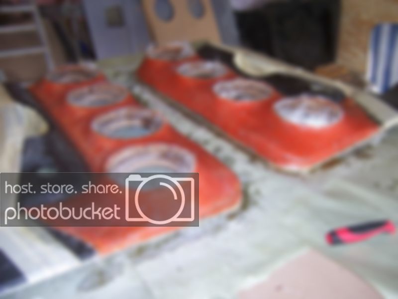

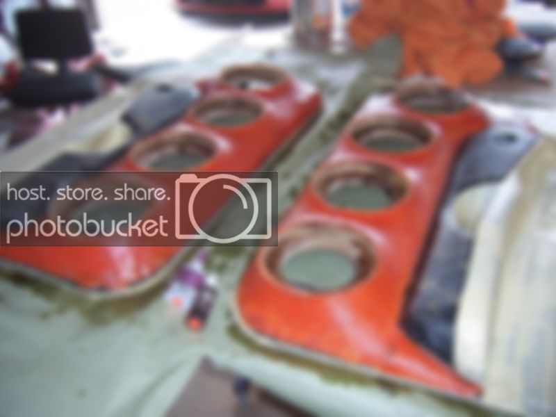

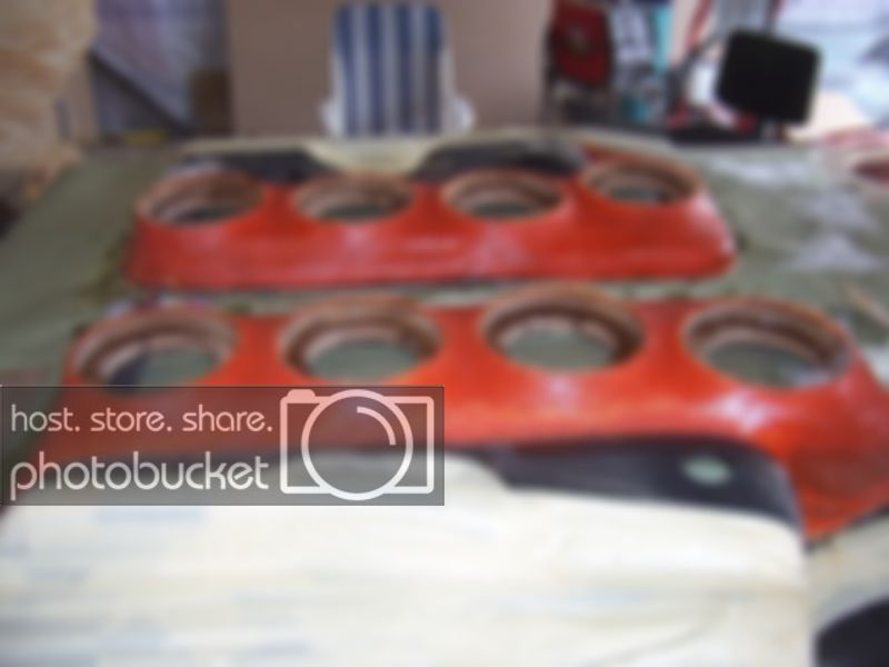

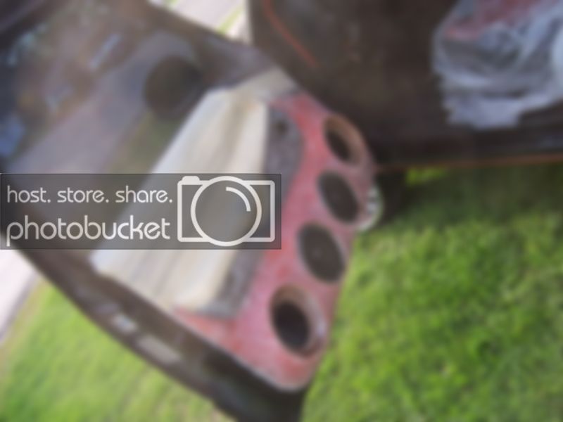

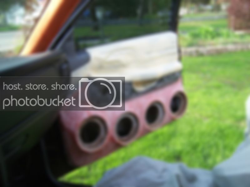

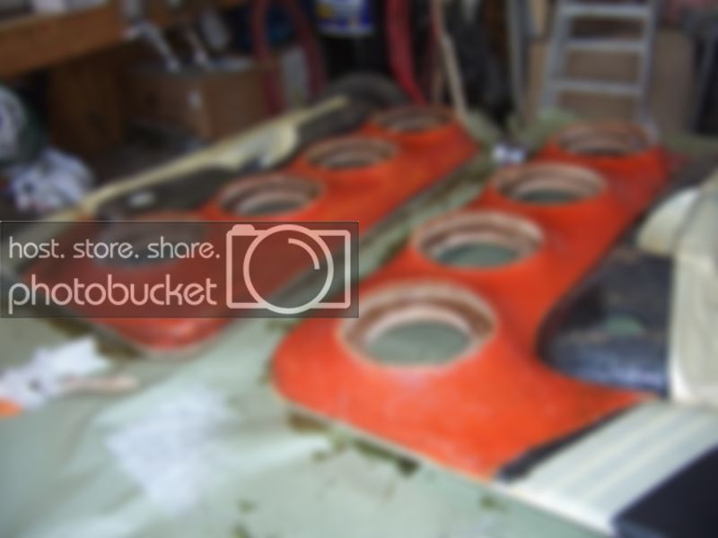

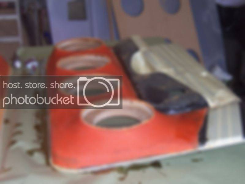

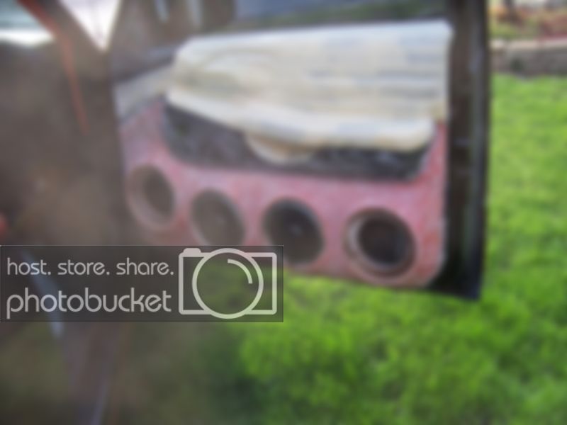

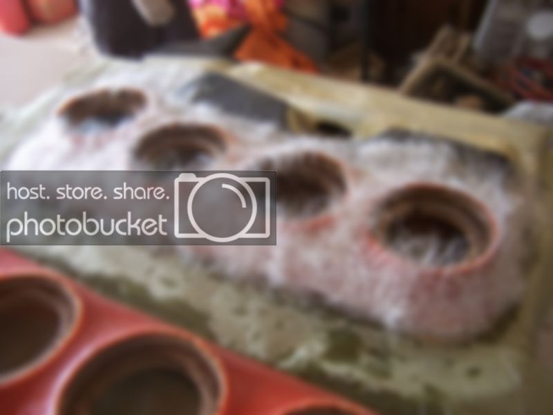

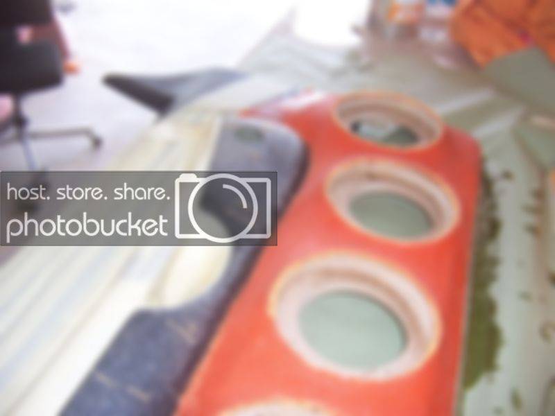

I didnt use fleece on the set im doing now. That stuff uses to much resin to soak thru. I used on of my Wife's shirts, a 95% rayon 5% spandex blend. That material had a ton of stretch and used 1/5th the amount of resin to set up. THe CA glue will soak straight thru it and makes attaching it to the panel a breeze.
Looking forward to seeing them finished.

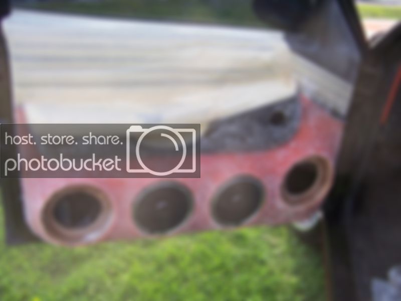

Next step is knocking them down with a 36 grit disc, glass them on the back side, then hitting them with some fiberglass reinforced filler.
