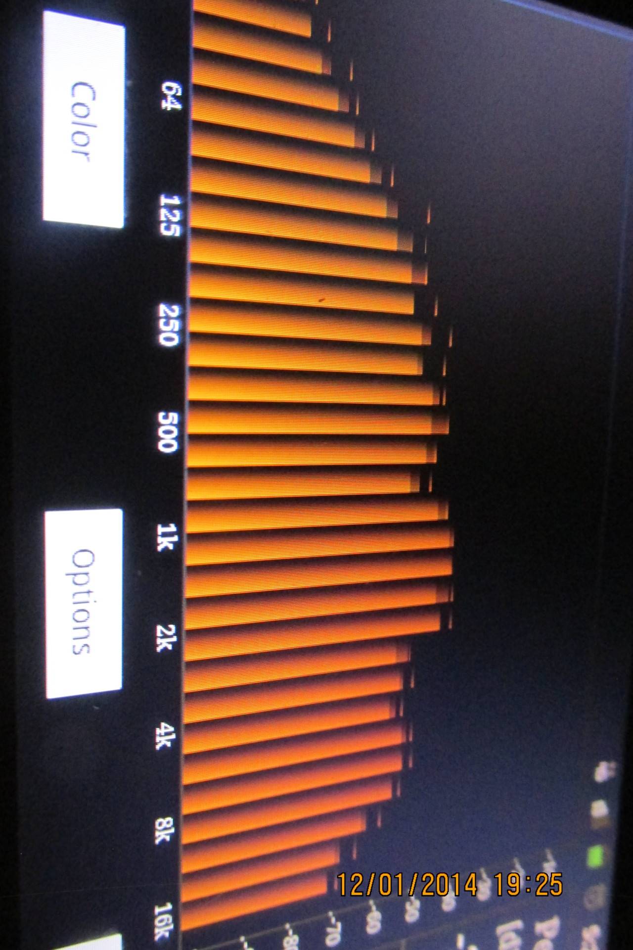

How exactly do i use an RTA? just run the woofer only, in full range mode and see at what frequency sound starts to drop im assuming?
i know you cant look at the frequency response curves the manufacture give you because thats only 1Watt at 1 meter and it changes drastically when you install it in a car.
Where it starts to attenuate is where you cross the tweeter and woofer. going higher if it sounds better to my ear but never lower than that point.
Am i on the right track?
play the woofers full range, one at a time, and note roll-off. it may be different left vs right but left should be worse (from driver's seat). use natural roll-off as the crossover point - both high and low.
frequency response curves from the factory are useless once you have them installed in a car door.
