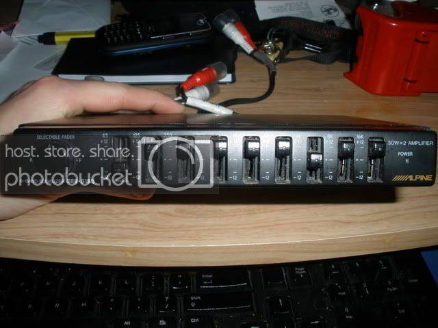

One i've used
Alpine ERE-G160 - has a 2 channel amp
I still have an older Jensen booster EQ sitting in my basement. Other companies made them, I just preferred Alpine products back then.
