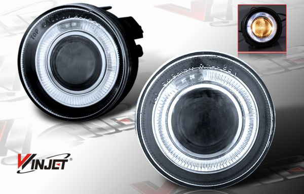

dont worry about it yet. get audio done and then worry abut fog lights lol.
i hate yellow lights btw. i think they are super ugly.
haha i need to FOCUS
I hate yellow to but for fogs, such as some bmws, it looks good.
But i drive no bmw so ill head the other way..
