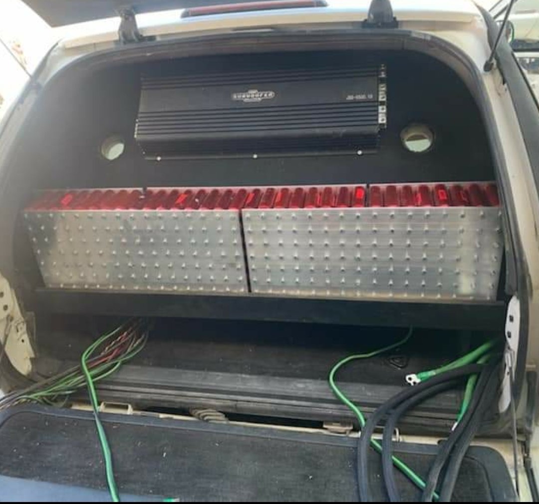

So I've got my lithium bank assembled and I'm working on getting the front battery out and everything mounted.

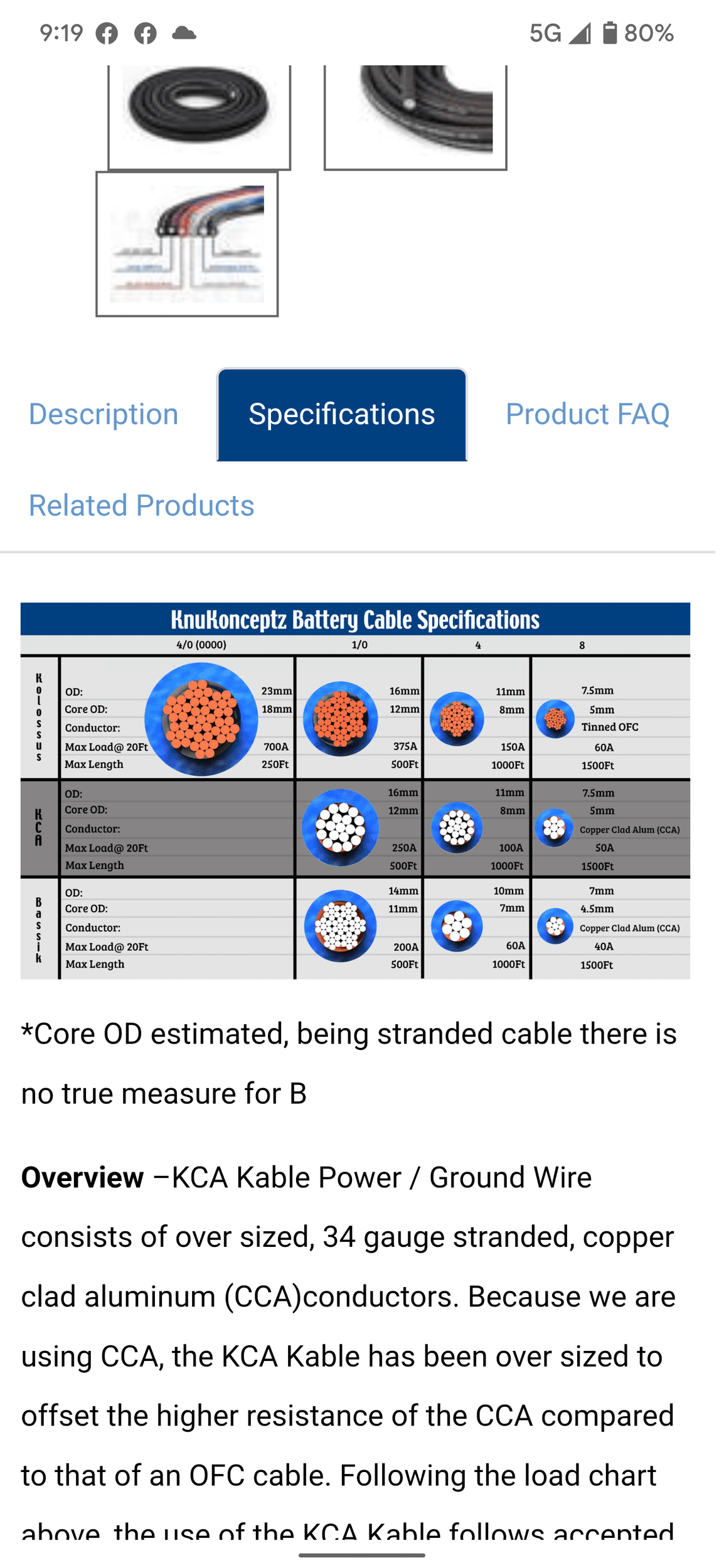

Currently I have a single run of Knukonceptz Kholosus 1/0 to the back, once everything is installed it will be about 10 feet of cable from the distribution block up front to the bank behind the drivers seat. It's a little hard to measure exactly, but 10 feet is the absolute max length.

I've always been of the same thought. No need to have 6 runs of welding cable if you are only running 200a of power. And in my case my factory alternator maxes out at 120A and my 1/0 can carry 300a no issues at 10 feet.

1 run should be fine knu can handle quite a bit of current
I have one run from front battery to rear battery, then two runs from rear battery to amp. The main reason is i despise running wire and couldn't find a path i was happy with for multiple runs.
I feel that. I found a route to completely hide my 1/0 run to the back. Not an easy task in a German car unless you go under the car. I'm only going to have the single LTO bank so my main concern was starter draw. But it's a small 4cyl so it shouldn't be an issue.
