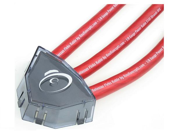

Ok thanks guys that's what i was thinking but i just wanted to make sure:D. but with all these wires will be running shouldn't be to bad my friend just told me what he got me for christmas the KnuKonceptz Battery terminal's:D . These one's
