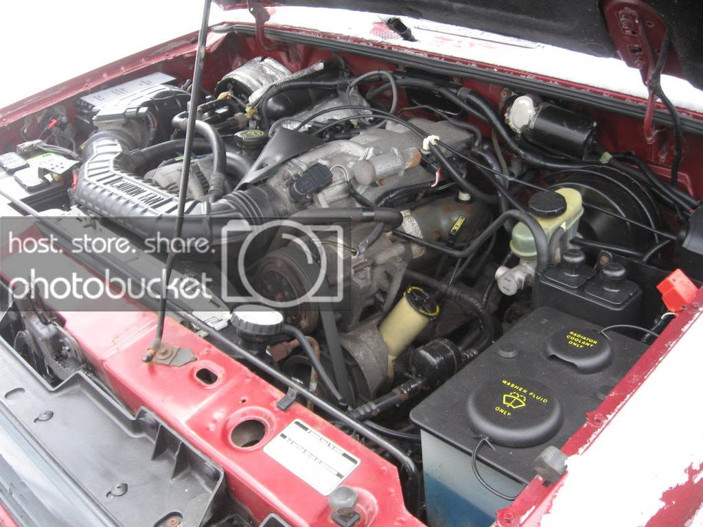

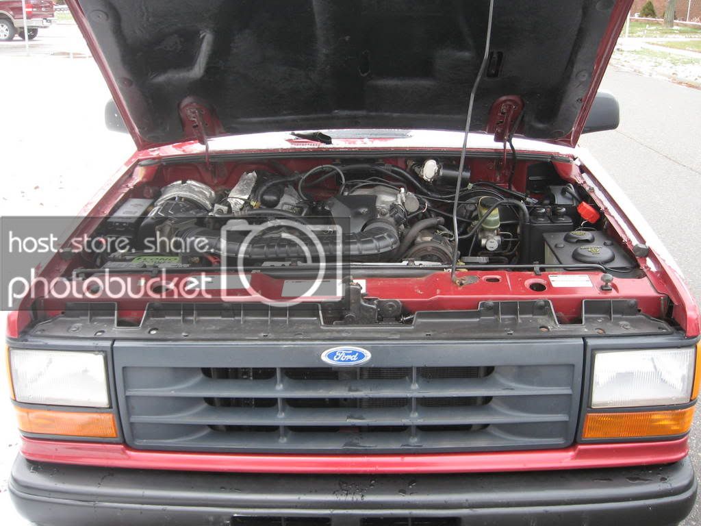

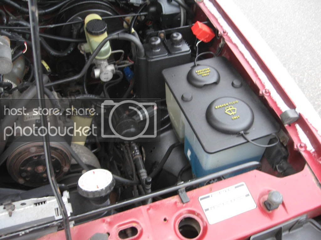

Well here are pics as promised:D.
Here is the washer fluid box i will be moving sideway's to make room for the other batt:).
