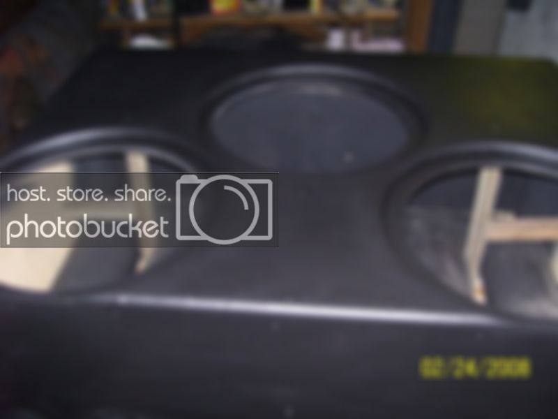

i just used 4 cans on the box i built today...
i've used it on two other enclosures as well.... about 9 dollars a can adds up though and if you want it to look nice you gotta use 3+ coats...
I picked up some from an autoparts store for $8 a can. It worked really well. I highly recommend using some cheap $0.99 a can black paint as a base coat first.
Not as nice as real bedliner but it can work. I would recommend priming and flat black base coat before applying. Also it is more expensive and troublesome than carpet, as it will take many cans and several coats to achieve a nice thick texture.
I haven't tried to roll on version but I've heard that it may give better results and is more cost effective.
my last two boxes i used the roll on i like the look better more rough as it actually shows the rubber bits i paid 50 for the duplicolor brand kit comes with a 1 gallon can I've done 2 boxes so far one 4 and one 2 cubes still have 3/4 of it left
