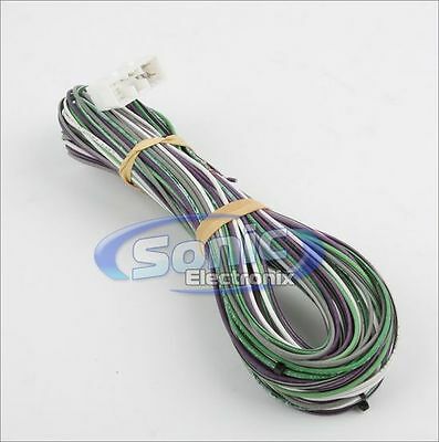

Here is the Infinity Amp Bypass harness that I need. Can anyone locate one for sale ?
- Xscorpion CHR-5622
Crutchfield or installer.com would be my two top stops for wiring and adaptors and such. Best Buy may well have that sort of thing either though it would likely be a special order I'd imagine there's some left in some warehouse or stockroom somewhere out of all their locations.
The black & grey is typical jeep wiring harness as I have a few of those laying around. That is a metra 70-1817. Metra makes one but it is a lot longer then that, never seen one like that before with them going into each other. Metra # is a 70-6505 if you are going to use an aftermarket amplifier.

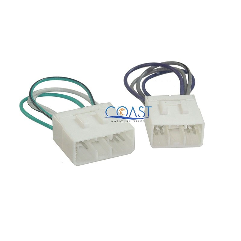

I was in contact with Metra today. They do not make an Amp Bypass Harness Kit for the 98 Jeeps. Xscorpion USA has no stock and may have closed since they no longer answer emails. I did manage to locate some in stock at Xscorpion Mexico, but they might not ship to the US. When I emailed them this morning, they responded by mentioning Xscorpion USA. If I can't locate the jumpers, I will just insert wires into the molex plugs, bypassing the amp
just to see if the noise goes away. Here is a picture of the Infinity Amp jumpers that I need.
Okay how is the aftermarket amplifier hooked up to the speakers in the vehicle? Is it separate speaker wire or did they use 9 wire Stinger/Metra Wire? Kinda curious on this.
Just do the jumpers instead if you have to easy to do and takes a few mins to see if it is the cause.
There is no aftermarket amplifier. My Jeep came with the upgraded Infinity Audio system which included a separate power amp under the rear seats. The video above shows someone installing the amplifier bypass jumpers to eliminate the factory Infinity Amp and utilize the head units built-in amplifier. I am only doing this to see if the factory Infinity Amp is the cause of the engine noise I experience.
Okay I mis-read the 1st post that is on me.
Just use the jumpers then. The head units built in amplifier is only going to be maybe 20 watts if that. It isn't going to see that 50 watts they claim peak.
I would personally just dump the stock amplifier and go with a 4 channel aftermarket since you replaced speakers depending on the brand of speakers you used unless you went back to stock.
