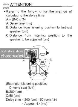

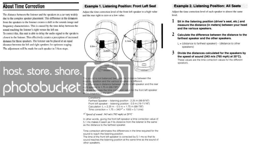

Your furthest speaker should have 0 delay as it will be the last to "hit" your ears. The closest should have the most delay. The object is to have the sound from all speakers arrive at your ears at the same time. I'm limited on time right now to do the search, but google time alignment and you'll find what/how to do the math to get you in the ballpark. the rest is actually how it sounds to your ears.

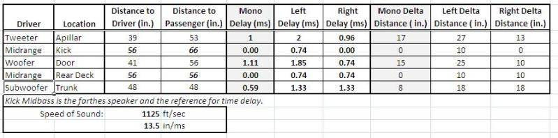

what i do is create an excel table that tells me what the difference in distance is between the closest speaker and every other speaker.
so, for each channel, measure the distance from your head to the speaker voice coil. then figure out the difference between each speaker relative to the shortest distance. that is what you use in the head unit for settings.

here is my spreadsheet
"mono" delay is for two seats. equal left and right T/A.
then i tweak from there.

Clarion got clever and did their time alignment in in/cm instead of ms, so people don't have to do the conversion. Keep this in mind when following instructions from a different manufacturer.

the mono delay is just equal left and right and based on pathlength differences to the driver's side relative to the driver's seat. an alternative method is to base it on pathlength differences of the passenger side relative to the driver's seat. experiment.
