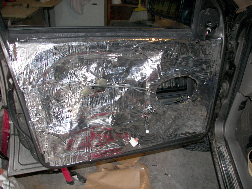

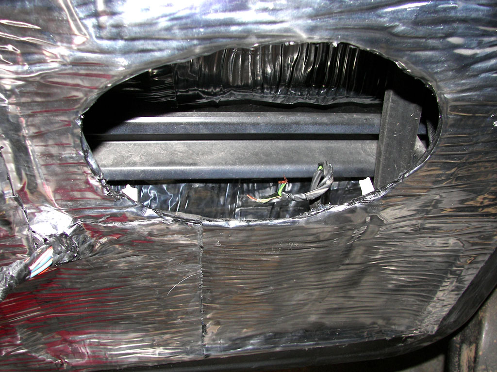

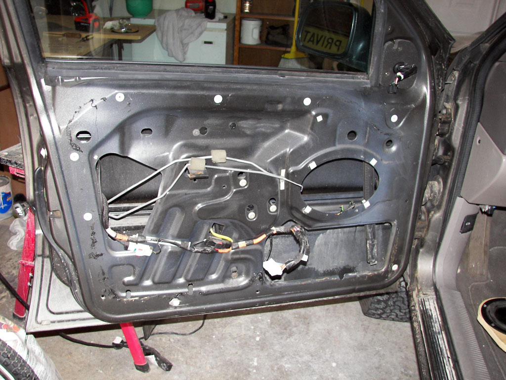

I hadn't got around to deadening the doors in the WJ till now. I took some pics along the way. I used RAAMmat BTX, I put two layers on the front and a layer on the inner door skin.
http://www.raamaudio.com/cgi-bin/index.cgi?p=pr
The woofer in the picture is a Dayton 7" RS.

It's pretty easy to work with, doesn't smell bad, and I didn't cut my fingers to shreds.
**** I have done my whole trunk I just need to do my doors just like you did.Bolognablake did you clean the doors like they recomend or did you just put the raamat on there?
