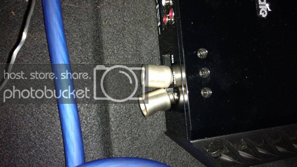

Only thing I did that I think was bad was I tried using 0gauge reducers when I first set it up and like an idiot I let the positive power hit the negative right on the amp and it sparked. The reducers don't fit.
Here's a picture to get an idea of what I did.
Could I have ruined it by doing this or was it something else? Maybe broke in shipping? He said he has videos of it working right before he sent it to me.

shorting out the inputs like that can definitely blow an amp, but you're very far from the first person to do it so dont let it get to you

yeah thats what the shop i took it to said as well, that its in the output section. And the guy at the shop said no way that shorting out the power wires would do that. What do you think?
I think you incorrectly installed the amp and you are looking for a way to say even though you messed up, there is no way this is your fault. If you are thinking that you want to send it back to the seller and get a refund.... That is horribly dishonest and most of us would say that is the wrong thing to do. You can't say if the amp worked when you got it because you messed up during install. Send the amp off to get fixed or take your licks and don't make the same mistake again.
