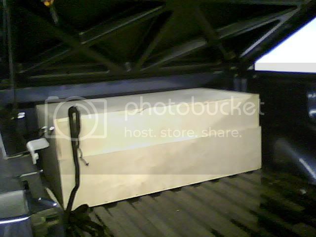

One of the guys I work with has an 05 F-150 Crew Cab. He has always liked Kenwood, and his truck is going to be our Kenwood Demo Vehicle.

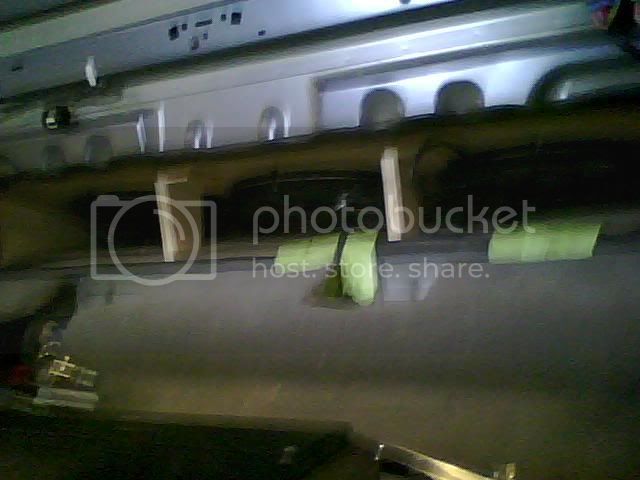

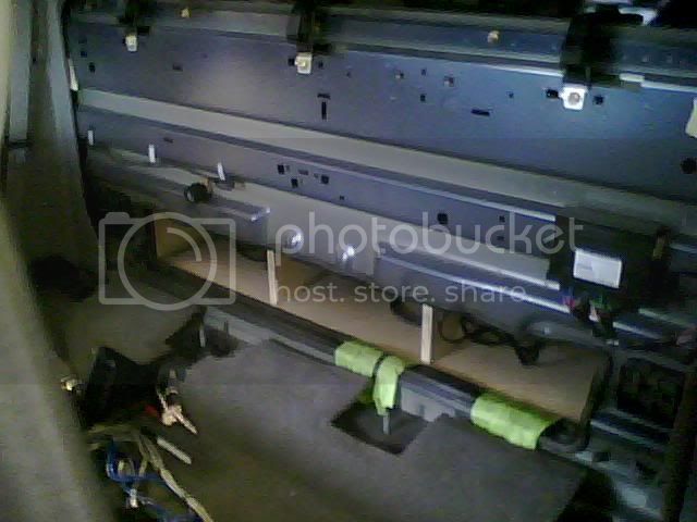

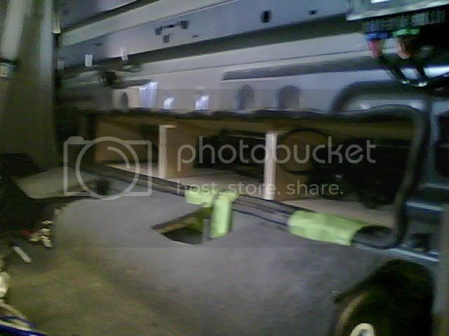

Did a cut-through into the bed of his truck today, finished it bout halfway through the day.
It has three Kenwood Excelon 13" subwoofers. And Three Kenwood Excelon X1R amplifiers. I Built and designed the box yesterday, it is 13ply voidless marine grade birch, downfiring at an angle, and features three separate sealed chambers, and a loading baffle on the bottom.
Few pics, will update as setup continues. It was just thrown in today... not even permanent yet.

Could easily do it with 2 18's. Our overall width was 46" so more than enough space.
They're downfiring at an angle, and the cut-through it the exact size of the opening of the mouth of the bottom loading baffle.
He only had one amplifier hooked up to one sub before he left after lunch... and it sounded GREAT. Excellent SQ and good output for one sealed sub, enough to make is headliner and console flex some...
IMO, downfiring is the only way to go in a cut-through... if possible.
