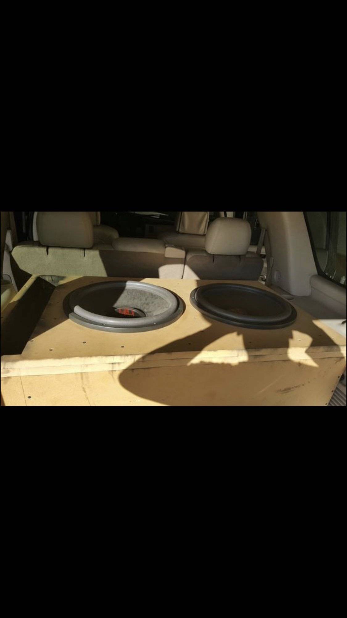

Dd audio 3518 dual 4 ohms ppi 10k amp dual alternator 275amps 3 runs of 1/0 skyhigh wire 3 deka gold group 31 battery’s I hear mostly hip hop rap I’m looking to slam the hell out of them I drive this truck just to pick up Kids from school so in my 15min drive want to be heard all around thanks for the help
The box I have right now is 10cf but subs face up and so does the port and it hits but when I face the post to the back it’s slams but then it’s like having a wall and I’m not liking that

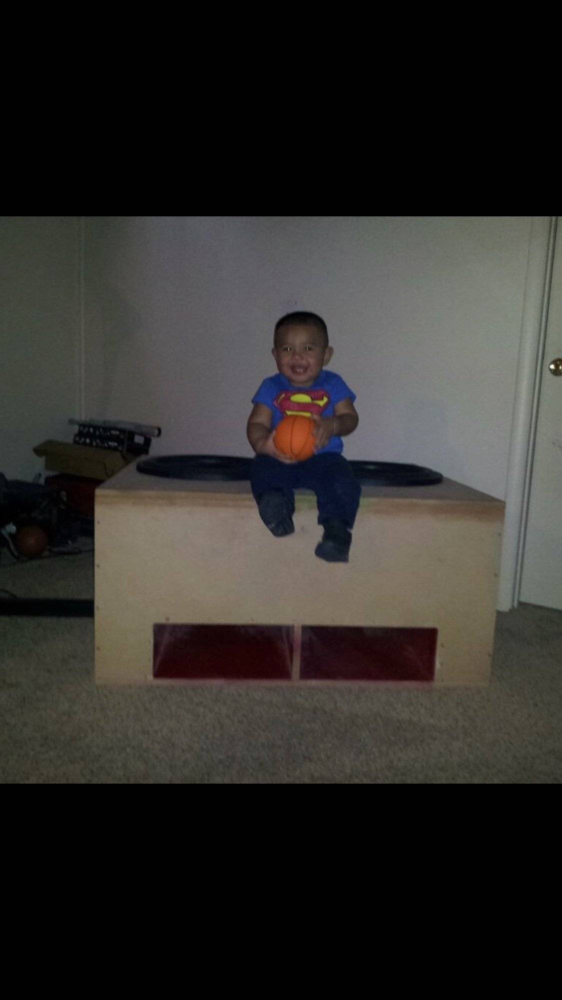

The box was a given to me they had the same subs in it. My old set up 2 re audio sx 18s hit a lot harder and box was bigger I want a box like the one I use to have want to see if I can get some help on some prints to make one
Too small for a pair of DD 18s and port firing to the back is optimum in Escalade. I'd get them into 14-16 cube, 225 square inches of port area tuned no lower than 36hz.
Should be high 151's with that amp once you get the box right.
