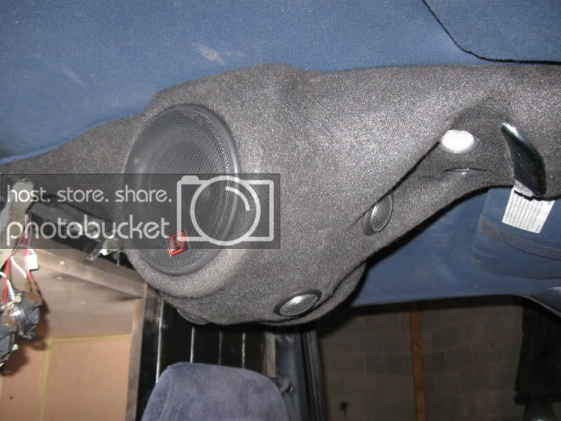

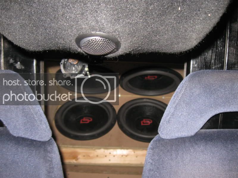

DD 4th order wall.
yeah i am actually planning on getting rid of the 3515s here at the beginning of the year...
i have been toying with the idea of a 6th order though
thank you by the way... i still have a lot of work to do... but it's been coming along... keeps getting louder every time i put a lil time in it. //content.invisioncic.com/y282845/emoticons/smile.gif.1ebc41e1811405b213edfc4622c41e27.gif

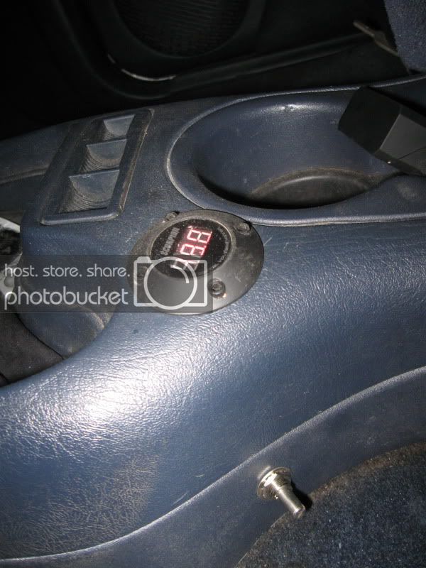

my lil voltmeter and my potentiometer for my voltage off my alternators:

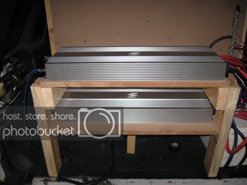

ok some numbers for you guys...
(this with volume at 21 on HU, I didnt turn it all the way up because I was more concerned about getting some spl testing with it done by tweaking with HU checking where the alpines sweet spot was) My volume I usually turn up to is 23-24 range and then turning up bass knob. the alpine likes to clip past 24 I have noticed.
@ 45Hz voltage dropped to 10.60v impedance after rise was 1.22 ohms I got 80.4A * 98.6v giving me 7927.44 watts = 153.6 Sealed on dash and ZERO clipping.
the best I have got out of them so far has been the 10,033w I clamped at 24Hz
