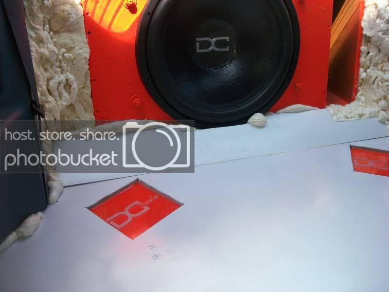

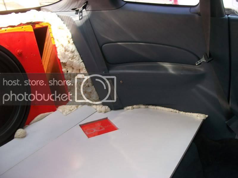

Put the other piece of the false floor in. Then i switched the 4 channels out, switched form 55x4 to 75x4.

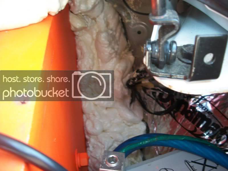

Also foamed the bottom of the box (was leaking air to the spare tire area) also foamed up some more of the sides of the false floor and the back right side of the box (thought i saw a leak -_- )

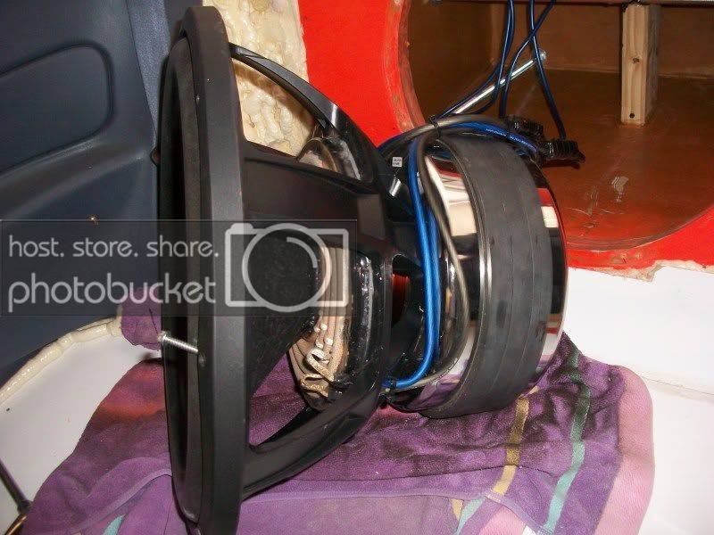

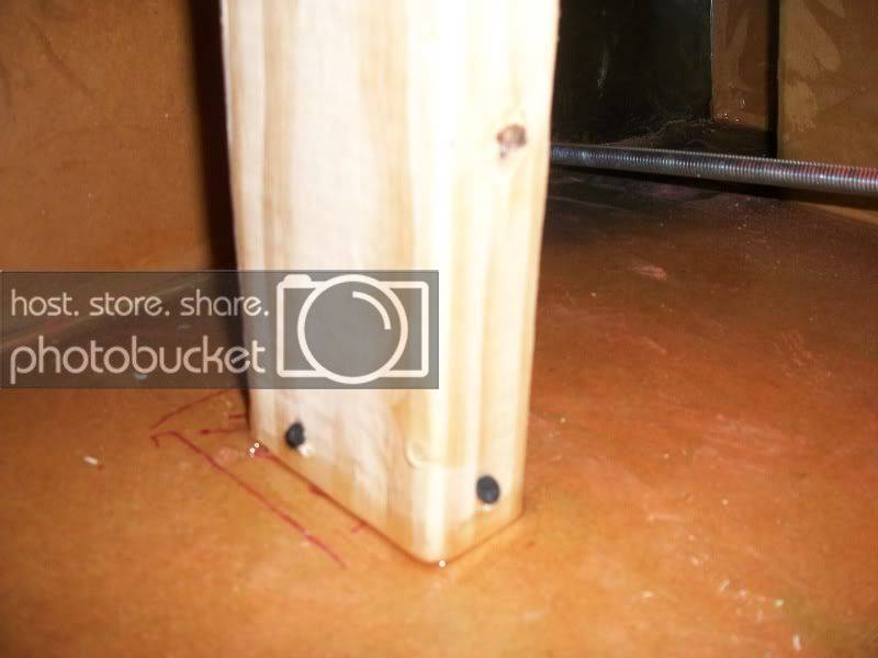

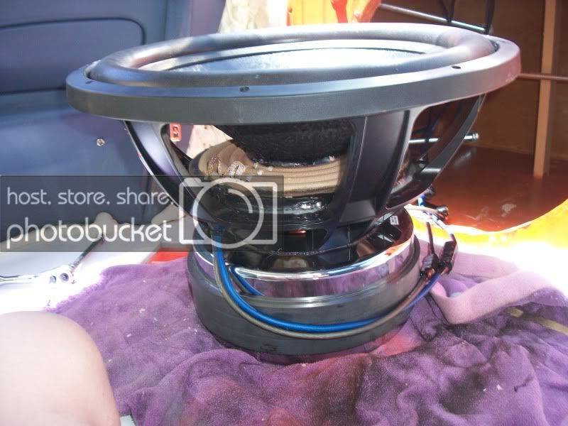

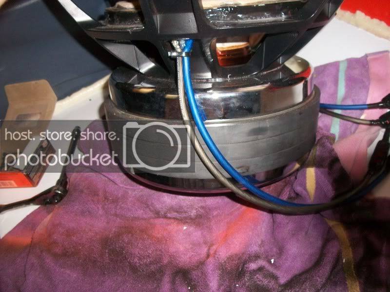

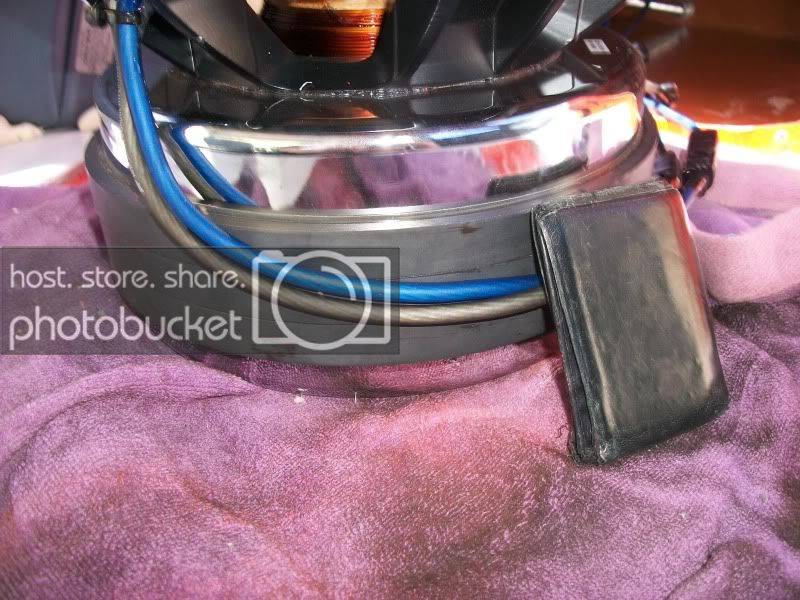

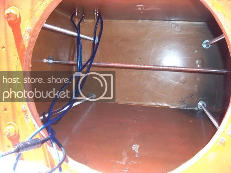

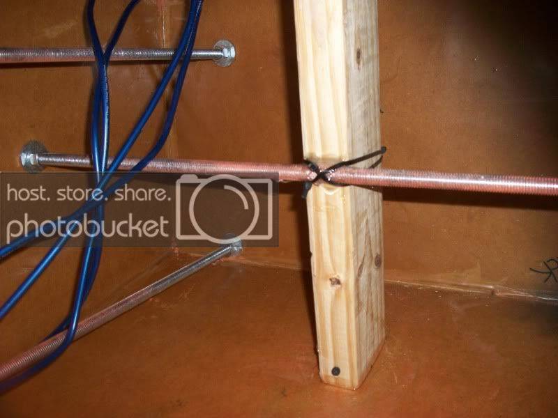

OK GUYS I HAD THE MDF BRACE IN THE MIDDLE OF THE BOX COME LOOSE SO I SWAPPED IT OUT FOR A STURDY 2X4. GOSH I HATE TAKING THE LEVEL 6 IN AND OUT. ITS A PITA! ANYWAYS I TOOK SOME MORE SHOWOFF PIS AND A VID OF IT INSIDE THE BOX SHOWING OFF ITS BADONKADONK!
THIS WAS THE MDF SUPPORT I HAD :/
AND HERES THE LEVEL 6 GETTING TAKEN OUT FOR THE 2X4 SUPPORT.
TOOK THE MDF OUT...
AND PUT THE 2X4 IN, WITH WOOD GLUE. SCREWS AND A BUNCH OF GOOP
AND THE *** END VID...
