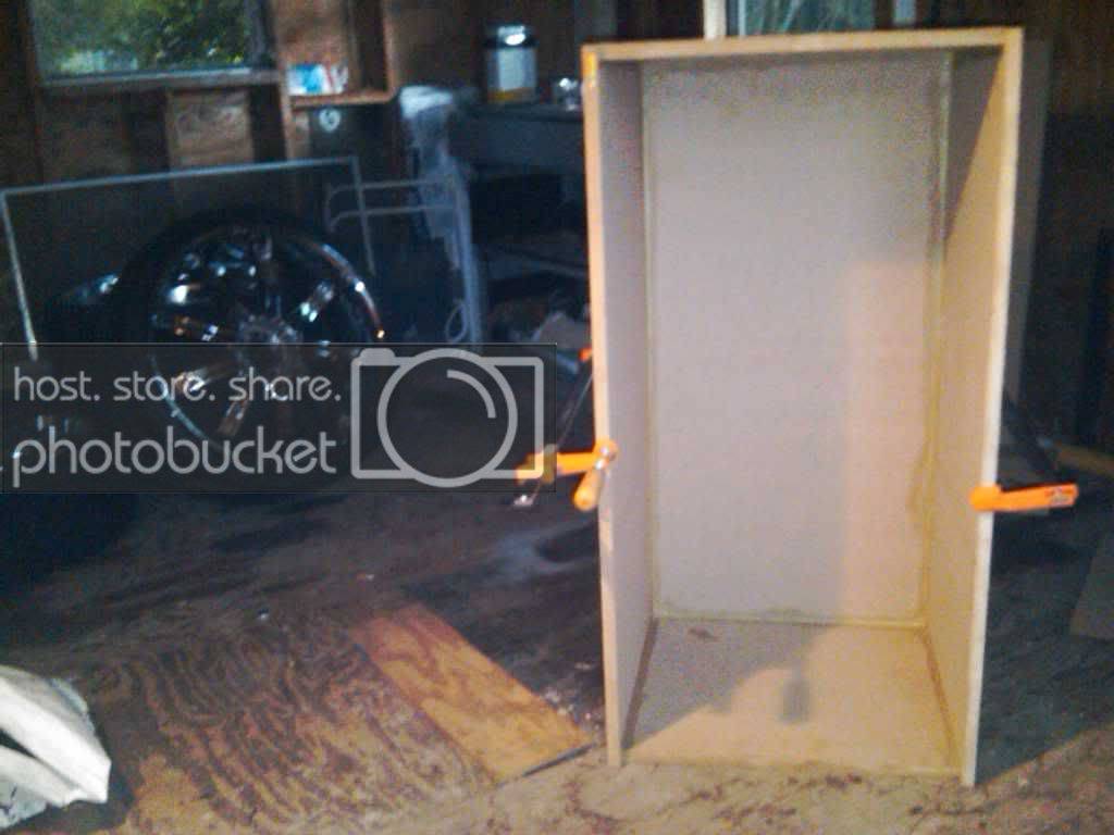

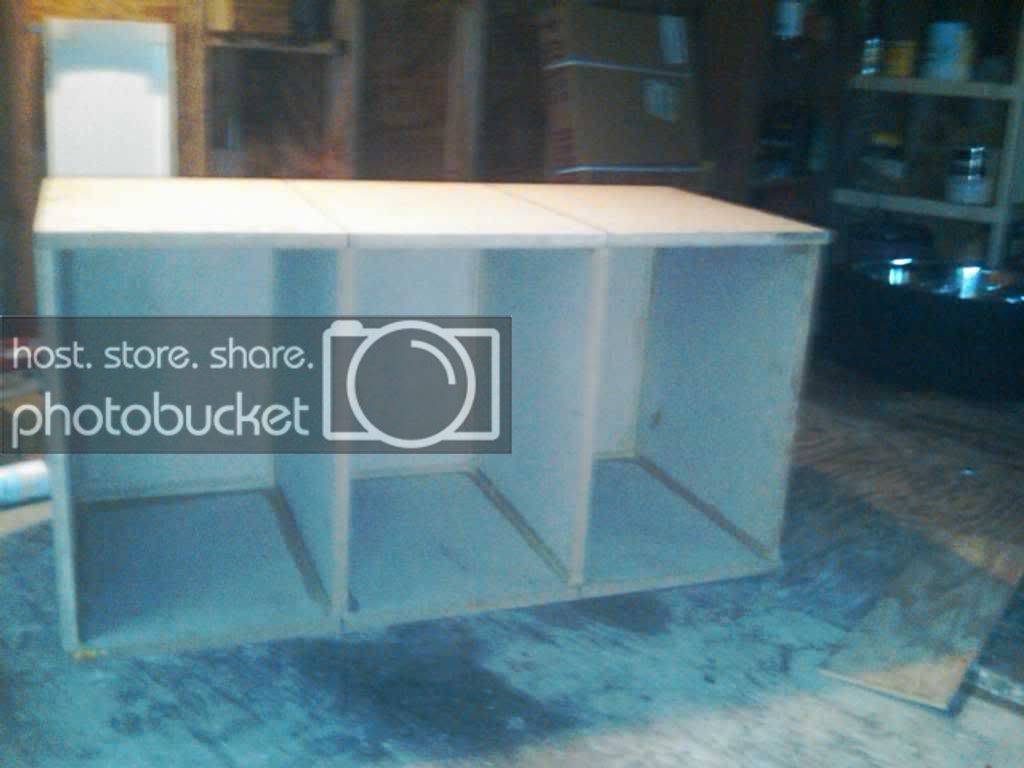

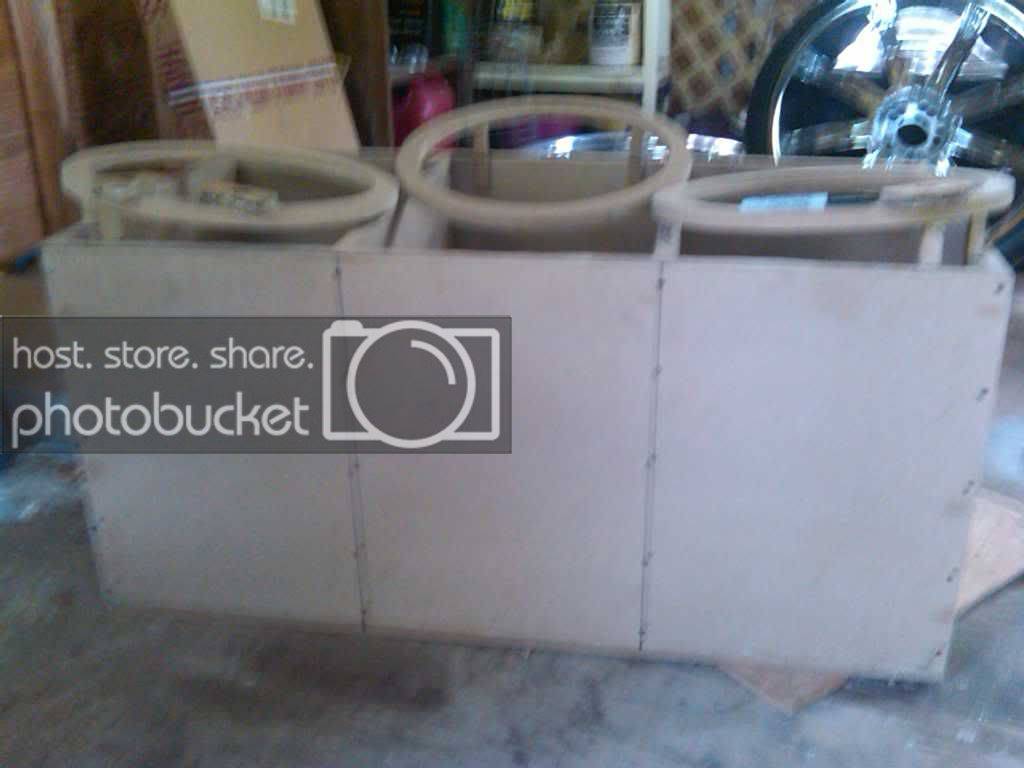

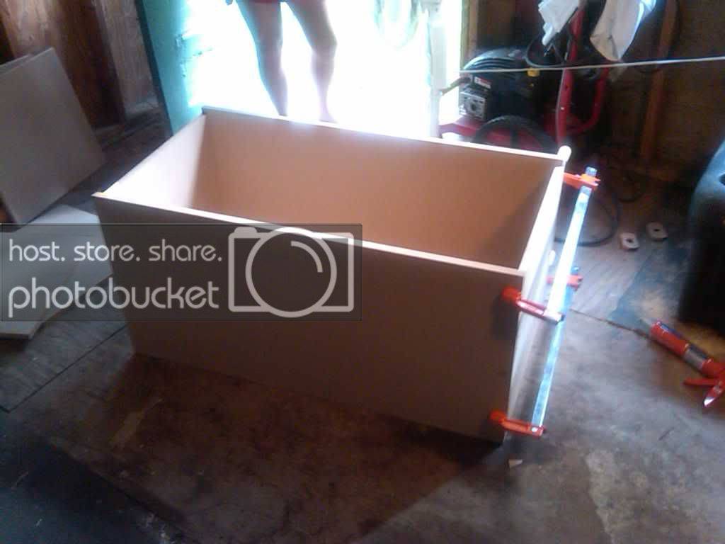

Puttin the base together

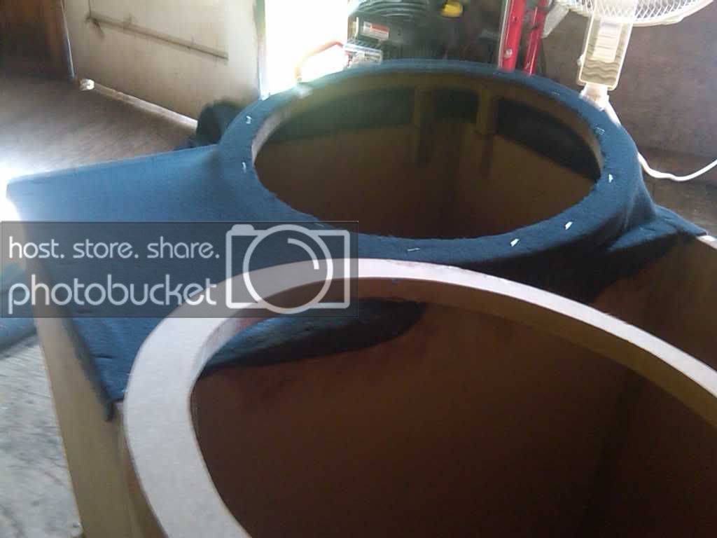

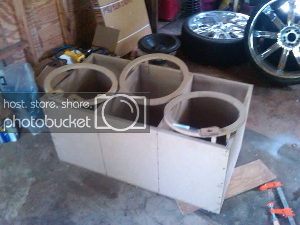

Rings in
The angles were crazy on this was hard to get 3 15" subs in a 43" frame so thats why i wrapped each chamber individually

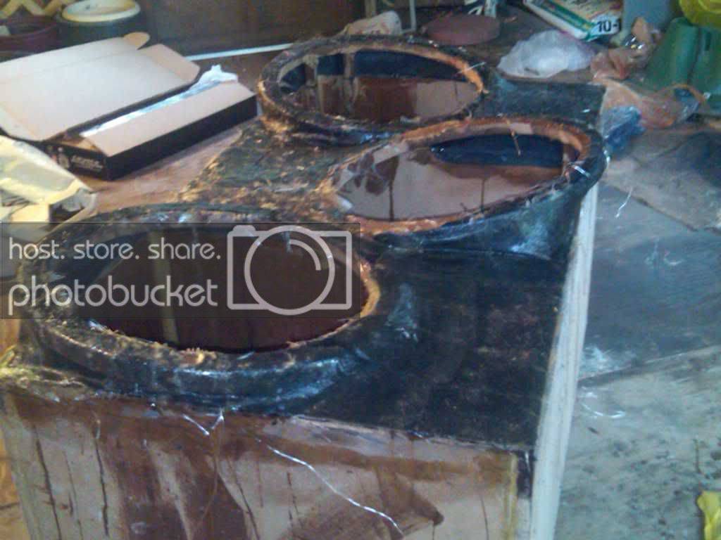

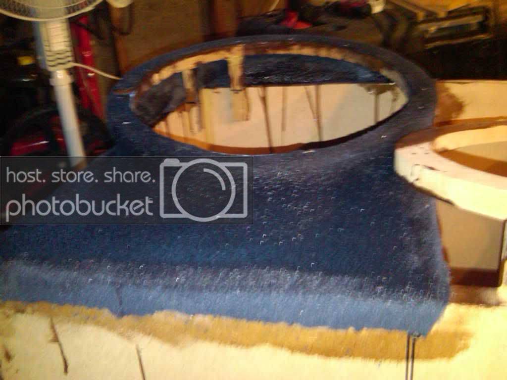

Layin resin on the fleece

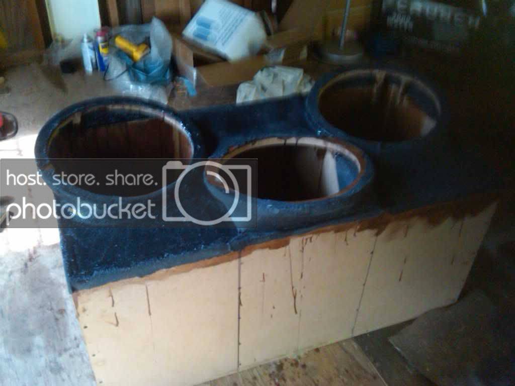

First layer of mat

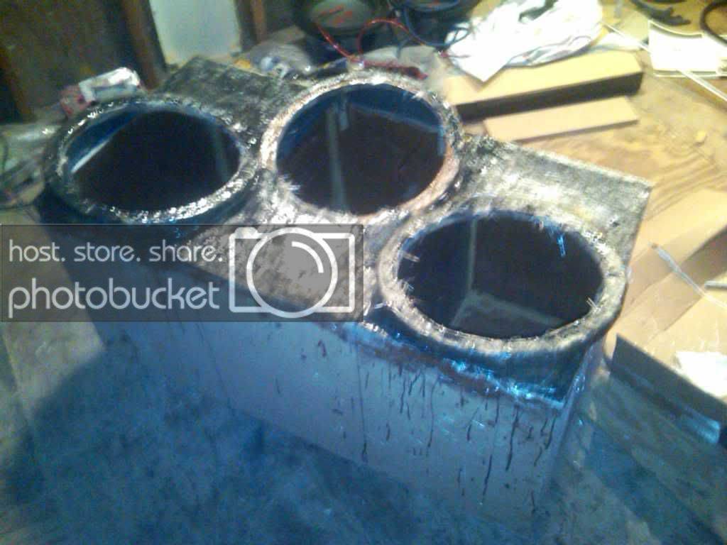

Second layer of mat
still have to drop ports in and more layers and tonnnss of sandin...anyways while im buildin this i have 2 of the ssds in a 6ft3 box tuned to 30hz on the gp3000 and im impressed...cant wait to get this done
