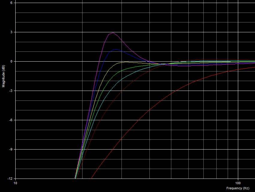

Could somebody please explain the following graph to me? What type of curve (color of line) should I try to achieve with box designs?

So the ideal graph would try to be as flat as possible to 0 db? Also, what does it mean if there is a huge peak to like 3 or 6 db?
It's just a preference. Ideal is whatever you want it to be. There is no right or wrong curve. It just depends primarily on application and your taste in music. Some people like a flat response and some like a little bump for extra output. It's all a compromise. Ask yourself what type of sound you're looking for. If you want a more balanced sound all around, get everything as close to 0 db. Huge peaks at 3 - 6 db will basically make a certain note sound louder than the rest. What are you trying to achieve and what music do you listen to? That's the real question.
Purple is the only real peaky one. The others are under a db. Even purple is not that bad.

Thanks for all of the help. I think I get it now. I just wasn't too sure how big of peaks were acceptable and how close to 0 db I should get. Thanks for the help guys!

In reality you need a RTA run after its installed. Tune it and try to have the sub stage 6db hot with a roll off to 0-3db at 80hz. Look up the JBL curve. That's a very good baseline for a proper curve.
This is like the difference between pink and white noise.
One is a constant amplitude up to 20khz whereas the other is a declining amplitude but, to the ear, with steady amplitude.
You would like a gain in the lower end of the spectrum as our ears require it to perceive a flat response.
