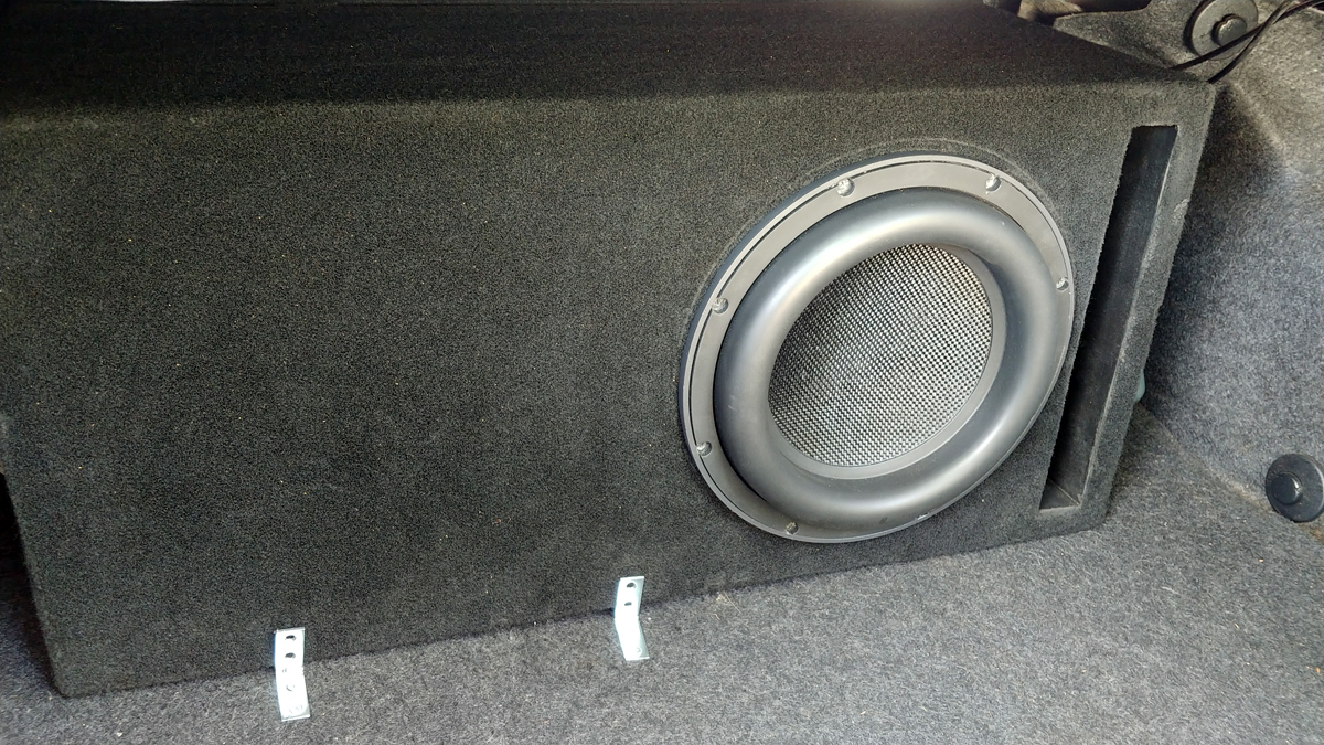

Ok, I swapped out my Punch P3D4 for an Ultimax 10. It sounds outstanding and has some serious low end. My question is how long does the hot voice coil smell happen? I play normal, HiRes music of the Jazz, Rock, Alt, Metal and it shines. I play some serious low droppin bass music and I get 30 seconds into some hella vibrating and here comes the voice coil smell. I know these subs are tough but should I be worried? How close is the sub to blowing the coils when I smell it? Could my RF Prime 1200-1 sub amp at 1ohm be too much for this sub? I know when I play bass music the cone gets crazy hot too.

I know the amp is rated at 1200w. I am not feeding the sub a constant sine wave though. If I had to guess, 750w-800w. Will know here soon. I am heading out to the car here in a few to hook up the O-scope/DMM
I was more worried about "breaking in" the sub. My RF P3D4 was "new" but it was broken in already by the stereo shop. Plus, there is no smell with non sub bass music. I am sure it is clipping though with ya'lls input. I will let you know.

I set the gain with a 40hz -10db tone. 27.38v @ 1ohm = aprx. 750w

I was being facetious. It smells like burning coil because he is putting over double rated power to it.
Clipping is the Boogeyman term used a lot by people who don't really understand electricity but it's as simple as you are putting power into the coil faster than it can be shed. Within the thermal limitations of the coil a square wave won't automatically burn it up.
Go ahead and buy a 4 inch 8 layer coil "team" sub and try to burn the coil up with a 500w amp
Which is still well over the rated limit for that Dayton. The fact that it's stinking at all tells you that you are over powering it how it's this a mystery to you?

Yeah... it got a little warm but I don't think any damage was done. It's in its original shipping box chilling for a future build. The coils measured fine. 1.9 x 1.9 ohms.
I decided to put the Dayton back in the car... this time at 4ohms and not 1ohm. My Punch prime amp says RMS 400w @ 4ohms and 499w Dynamic @ 4ohms. So back in the box it went at 4ohms and I adjusted the gain by ear, max undistorted volume, no eq or crossover changes and up the gain went. I got it to an output where it is comparable to the Punch P3 on music. I beat the hell out of it with Bass Boy, D.J. Magic Mike, Ron C, Morbid Angel, Thomas Dolby (Pop Culture) and when I got into the trunk and touched the cone it was BARELY warm. No more hot burning coil smell either.
EDIT: This box is the closest to Shredder's recommended enclosure for this sub. 1.40cu.ft. @ 35hz.
