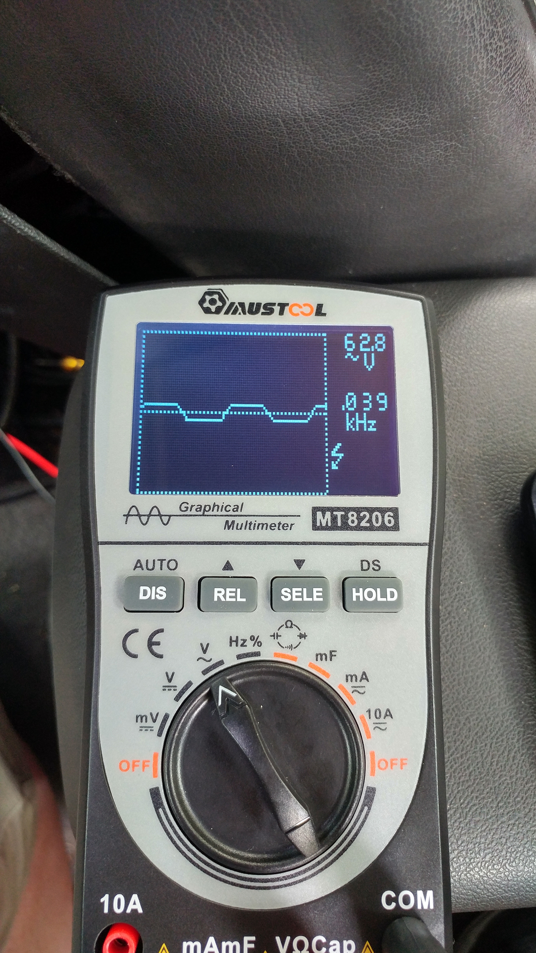

I know the amp is rated at 1200w. I am not feeding the sub a constant sine wave though. If I had to guess, 750w-800w. Will know here soon. I am heading out to the car here in a few to hook up the O-scope/DMM
I was more worried about "breaking in" the sub. My RF P3D4 was "new" but it was broken in already by the stereo shop. Plus, there is no smell with non sub bass music. I am sure it is clipping though with ya'lls input. I will let you know.

Sub smells like burning electrical wires... As stated, it's CLIPPING!!
Thanks Popwarhomie and hispls.
She was clipping like a mother ^@%#$

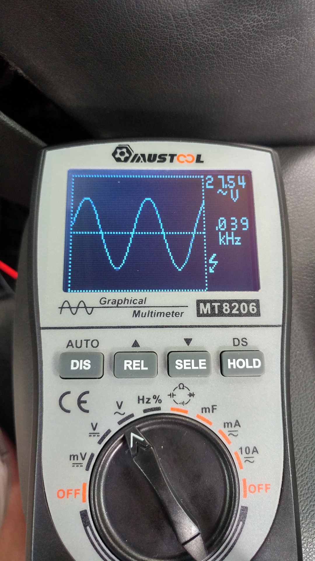

I set the gain with a 40hz -10db tone. 27.38v @ 1ohm = aprx. 750w
BEFORE
AFTER

Yeah... it got a little warm but I don't think any damage was done. It's in its original shipping box chilling for a future build. The coils measured fine. 1.9 x 1.9 ohms.
I decided to put the Dayton back in the car... this time at 4ohms and not 1ohm. My Punch prime amp says RMS 400w @ 4ohms and 499w Dynamic @ 4ohms. So back in the box it went at 4ohms and I adjusted the gain by ear, max undistorted volume, no eq or crossover changes and up the gain went. I got it to an output where it is comparable to the Punch P3 on music. I beat the hell out of it with Bass Boy, D.J. Magic Mike, Ron C, Morbid Angel, Thomas Dolby (Pop Culture) and when I got into the trunk and touched the cone it was BARELY warm. No more hot burning coil smell either.
