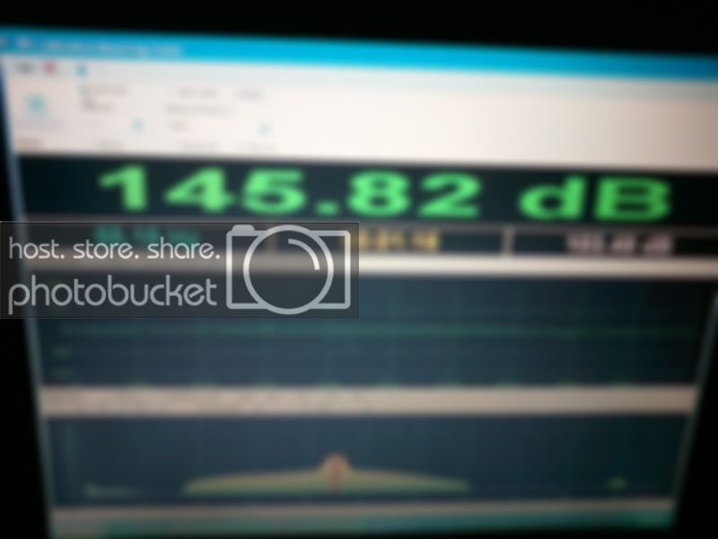

So as I expected. My score went down because of my batteries. I charged them, burped it today, 145.96. Does it count as a 146!? Maybe...? No. Just turn it up a couple more clicks even if the red light comes on;) to get this.

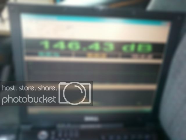

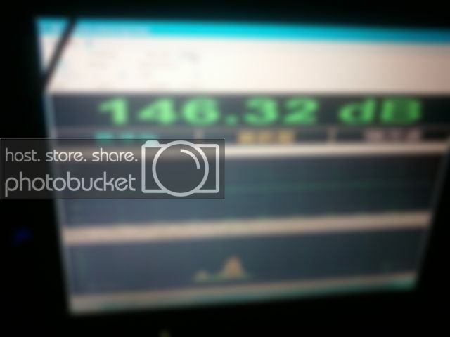

So today, I took off the carpet of the prefab box, and you could see through EVERY crack. Hmmm....So I sealed it up. I noticed that one of the pvc pipes were loose so I sealed it up and tried the 4 4" ports again. Ports are 13" long.
Score!.....146.3! The slot port was still louder. It has ~64 sq in. port area. And the leaks sure didn't help it. So I think I need more port area 2 8" ports? Mhmm. Yes? Lol. Or a single 12!
