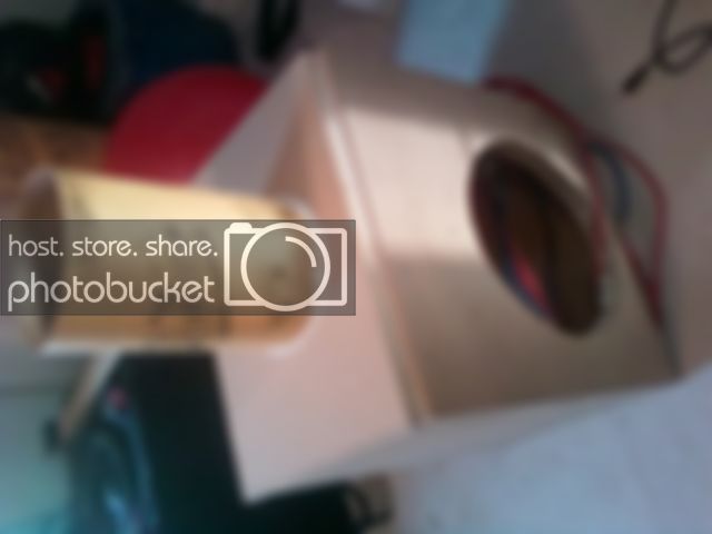

Ok. Finally got another test box built. Port is 18.5x6 and 25" long. Which gives it about 3 cu.ft net. with a tuning of 54. The port isn't sealed...well...with duct tape. Anywho. I haven't charged my batteries in like a month...and with no extra help from the interior, just the door open....And the box....just a box, not sealed really or rounded anywhere.
144.7 @49 hz.....a decent score, better than my other box so that gives me hope. Mind you this is my 3 year old hdc3 wired to 1 on a 3k amp, not the massive. I did a couple interior things later and pushed it past 145. I'm almost sure if I throw my massive sub in, I can get over a 147.5.
A weird side note, my sub hardly moved compared to my other boxes, it moved maybe a half an inch. The other box I had it in looked like it was going to bottom out....
Then I charged my battery, took the port and shrank the width to 4.25" from 6".
Score. 143.9@ 47 Hz. Almost a whole db down. My car loves 55 hz so i'll put the port back at 6" test with charged battery and then go out another .75" Then cut down the L shape port to try to get that peak up around 55.
So today. I went out, extended my port to 6.75" from 6", I hit a 145 even with my fully charged battery but then it leveled off to a 144.7, just kept getting a 144.7 so just to be sure it was just an off day, put the port back to 6" and the score dropped. Cause mind you it was a different time of day, temp, everything like that. I cut the port .5" at a time, and now have it 144.9 consistently. Best I could manage without moving interior things around was 145.1. Still peaking at 49.
I'm really itching to put my massive in there. Cause with all the gains i've gotten, I don't see why I can't hit a 148. We'll see;)
So basically. I cut another inch off in the port, score went down to 144.5 or something like that:( So that got me all depressed;) So I had to throw my massive back into my magic box. Scores.
