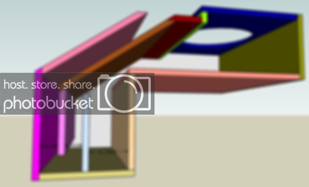

Well, my new box for my FI Q 15 is going to require multiple angle cuts of around 56 and 34 degrees on different pieces. However, i have yet to find a table saw that cuts anything over 45 degrees. Is there any "cheat" method to get it to cut at a higher angle or anything? If not, i'm kinda scrweed..
Do you mean just cut any angle where both angles add up to 90 degrees? The only way to do that would be to use 45 and 45, and would that even work..this is what im talking about..u can see where the angled cuts need to be. the person that designed my box said they need to be 56.309 and 33.690
What do you mean a rough build..yeah its gonna be challenging..sorta
I'm still confused. No matter what they have to equal 90 degrees. And the only way to keep both numbers at 45 degrees or less is to use 45 and 45
I understand what your saying, but i don't get how that would work. Say you need a 60 degree cut. You set the blade at 30 degrees like you said. Won't the 60 degree angle be on the tiny little piece of MDF that is left over?
