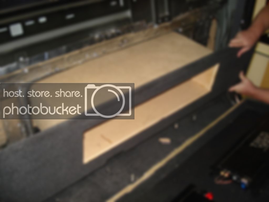

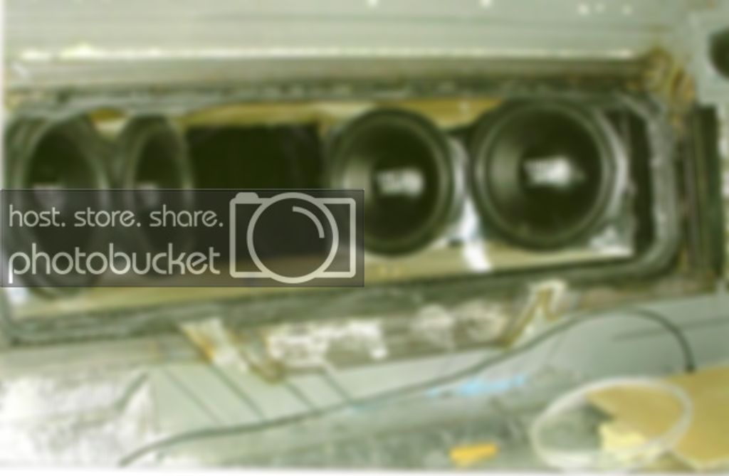

The first picture is a new Chevy truck with a bed-cut 3-12”
And it is a Band Pass; what see is the port going in to the box
The first picture is a new Chevy truck with a bed-cut 3-12”And it is a Band Pass; what see is the port going in to the box
Sorry I was referring to the bottom picture with the baffles in a V and the port in the back. Does the size of the area in front of the subs kind of create a 6th order bandpass effect?
