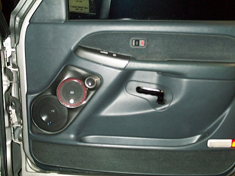

Custom Box ,Amp Rack & Front Doors Pods..
I would be doing Something Like This
(Pix Are for Refrence Props to the Guys That Made Them)

Yeah, they have really good prices on those boxes. As for location on the speakers, we kinda need to know what your plans are for the vehicle. Putting the midbass and midrange in the door doesn't really work out best for imaging and staging so it really doesn't work best for sq. If you are just wanting something that will be loud and don't have any time correction or eq's or or don't want to build kick panels, just leave them in the doors. Like I said it isn't an ideal location...but it will work. I had good luck out of mine with both midrange and midbass in the door but I had eq and time correction to help out with path lengths and all. Of course it only sounded good from the driver seat.
i would advise not to put both midrange and midbass speakers in the same door...

I would like it to sound good SQish..
Nice Stage & High vol. but get very loud since its his Baby he wants to make it B0oM
I live in AZ He lives in TX.. I was going to make everything That I can before going down to TX & Taking time off work to install..
I Have a GMC Door At my work but no kicks.. (Door was damaged)
So We have it in the shop..
So Iwas thinking this would be a nice custom look with good sound..
The Lade has a Massive Center console so I didnt think kicks would work so well..
Maybe I will just do 2-Way K2's insted.. & make a nice looking Door Pod..
