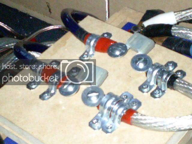

this is the old maxi fuses, but it could easily be adapted for ANLs
it only cost like 5 bucks too
