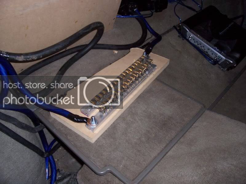

Custom SPL fuse block
i am goin to do somethin like this

We thought that too, but at the great 12 challenge we actually burnt 2 bolts like that, and it quit conducting, but we were passing 10kw through them for minutes at a time
for somethign quick and dirty get some ring terminals and bolts and then screw an ANL fuse between them, then use waterhose clamps to mount it to a piece of mdf
what are the silver things tommy, the silver spring looking metal where the fuses should be?
Those are bolts that I cut the heads off of to replace my fuses. //content.invisioncic.com/y282845/emoticons/biggrin.gif.d71a5d36fcbab170f2364c9f2e3946cb.gif
They aren't even brass *rubs temples*
TommyK, you make me sad in my pantaloons.
Then do something like that... except with out put two. Hah.
Why can't you just get a wafer-style fuse holder and stack 2 300A fuses on top of each other?
needs to be less than 80 amps worth of fusing.. I currenty have (5) 300 amp fuses and need to cut that down to only 80 amps worth fusing... Lower class in MECA event

By the sound of things you are running S2, (80x10)+176=976.

Seems like if you had 10X40amp bus fuses in-line they would count that as 400amps
So at the competitions they dont go by Total fusing only what an individual buss fuse is?
I don't quite understand.
they do lakota will remove all but 2 40's for comp..
