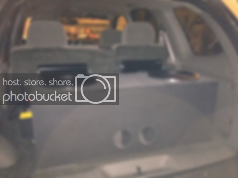

pic of my box.....
its 4cubic ft tuned 32hz i ended up painting it with flat black and then a stone type texture color. Not the best but.....
also, would i be able to put two more 4" ports in this enclosure?
A router with a roundover bit is the best way to round over the edges, the next way would be to snag some sand paper and go to town on sanding.
If you paint the enclosure I highly suggest sanding all areas where wood meet up with another to smooth them out and then bondo them and smooth them to get rid of the seem. It will make the painted enclosure look 10x better then if you didn't all of that.
pic of my box.....
Ok, given the power, subs, and vehicle you have....i would stay that it is likely that your hear some some port noise at high volume.
I looked at your post sig...
HU: Kenwood DDX418
EQ: ???
F Stage: (2)Arc Audio KS6006 component front and rear
R Stage: 2 Arc Audio Flatline FL12D4
Box: 4.0 ft^3 2x 4"-port tuned @ 32Hz
Amps: (2)Arc Audio KS1000.1 & (2)Image Dynamics i2300
Wiring: 1/0 xscorpion wiring, Streetwire cbr44s
Electrical: Stinger SPV35 *rear*, Big 3
Here at the shop, I carry Xscorpion and ARC. I know that their products are not lacking in the quality department. (As long as you have Xscorpion Expert-Link 1/0ga that is).
I do not know the actual box specs of your current enclosure, but adding 2-4" ports to the current design would effectively raise the tuning ALOT. Likely ~15hz rise in tuning.
