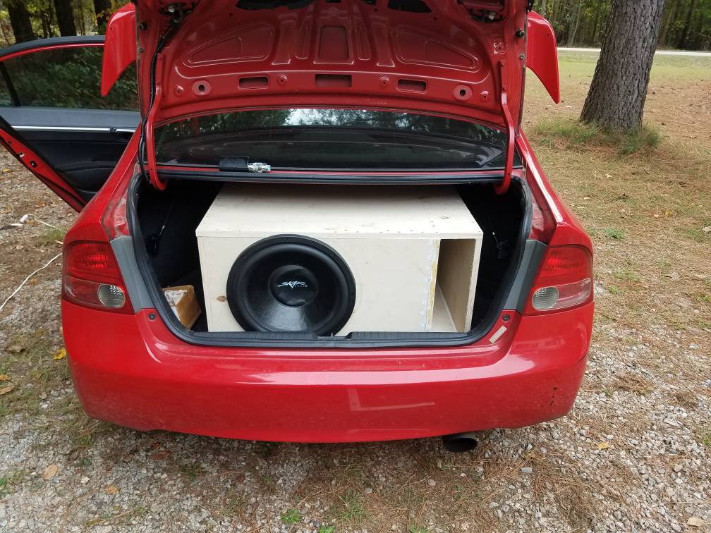

What kind of car is it going in? I just put mine in 2 days ago. It's in a 4.3cf box tuned 36hz. It gets down but it does take up the entire trunk. Buddy of mine has 2 ddx 15s in a box too small in his trunk. My 1 sounds just as good bc I have the right box.

yeah like jeff said if u wanta spend $ get FU 15 $200 i think run all that amp to it in 4.5cf u be happy.. but the ddx as u see in pic above will do good too in proper box.. either way get box built for 1 15 use ddx in it and later u can upgrade sub (to an FU audio lol)
