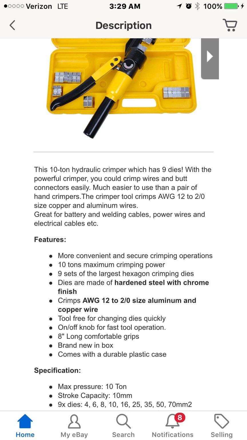

Get one of these off eBay or Amazon only way to go... 25-35$

I suggest using a GOOD hydraulic crimper. I'm not talking about a $2,700 Greenlee but not a $20 one either.
You must be careful purchasing cheap crimpers-
1- They are all made overseas in China mostly and their dyes they use are all metric.
Even if they list works from Range A to B in AWG ratings, it's Metric conversion ratings, it's not actual AWG ratings.
So, when purchasing lugs/terminals that were designed by the AWG rating, Metric dyes will be slightly off when crimping.
2- The Dye design. Cheap crimpers will use a dye design that may not be very effective once finished crimping. This will have an adverse effect on the longevity of the crimp over time.
3- The Bleed off Line. This right here is why I opt for a high quality Crimper. Yes, one that's closer to $300-500 range just for this.
If you do large installs where you will be crimping hundreds of terminals at a time, it's only wise to get a crimper with a bleed off line.
That way when crimping, without one, you risk blowing or leaking fluid from the crimper over time from putting too much pressure on the crimp.
With a bleed off line, the crimper will always drain excess fluid away when overcrimping to prevent a blowout.
