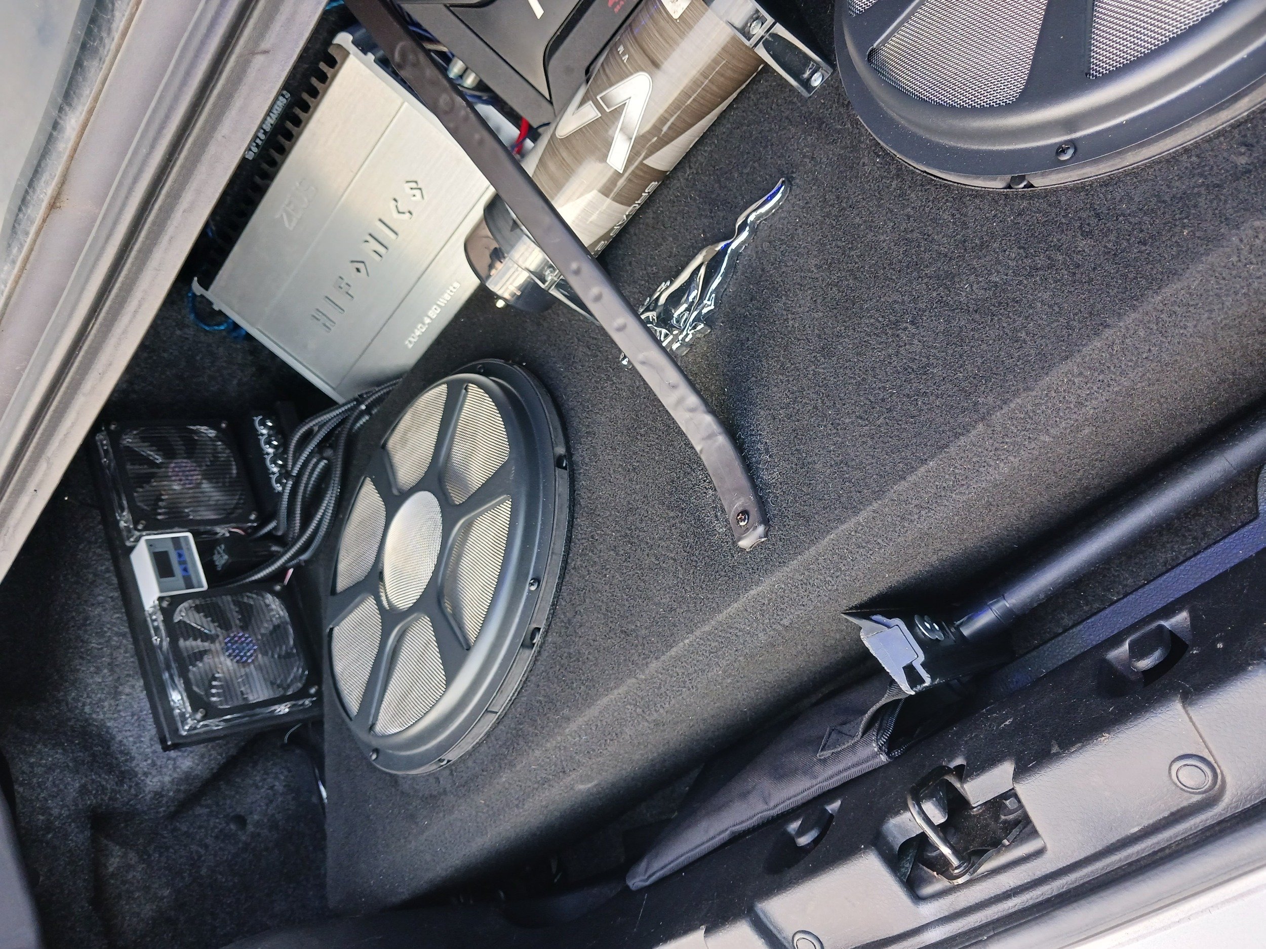

I installed 2 fans near my trunk mounted amps. Never had any overheating issue, but installed them as a precaution. Your cfm seems adequate if you have not experienced any overheating. My fan are powered by a relay, which is triggered by an adjustable thermostatic switch. Good luck with your project.

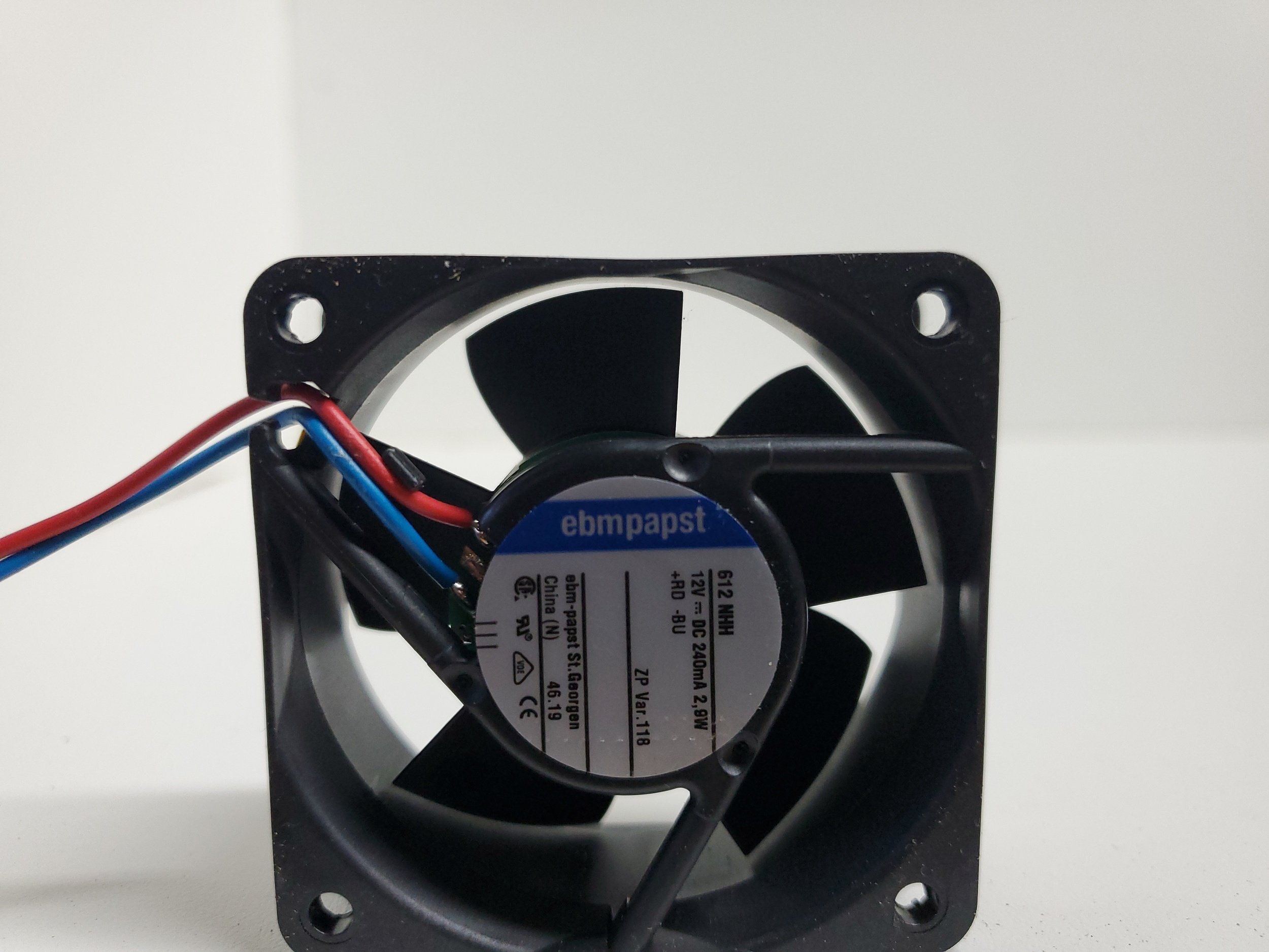

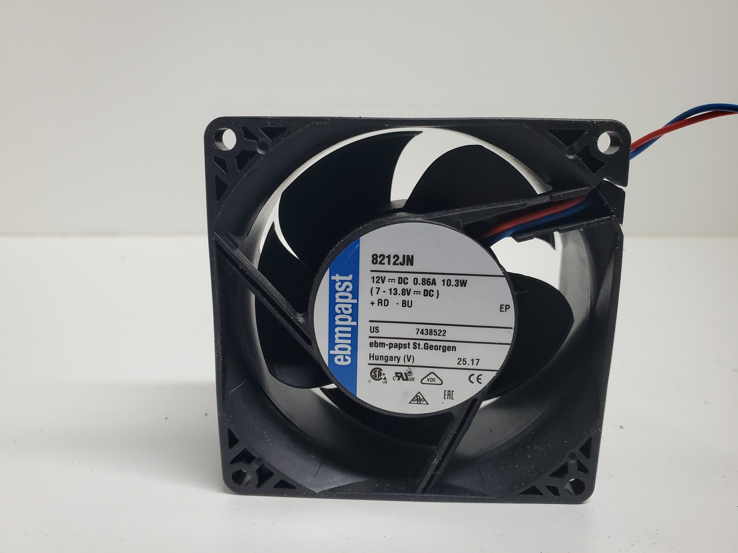

I have a ton of fans I'll sell them for dirt cheap plus shipping I have way too many and any one who needs some just hit me up.
I have around 100 of these collecting dust lmao I'll make a solid post with the name and all that if anyone really wants some. 1.00 plus shipping for the 612 and 2.00 for 812 they cost 5x that amount. Not trying to offend anyone.
