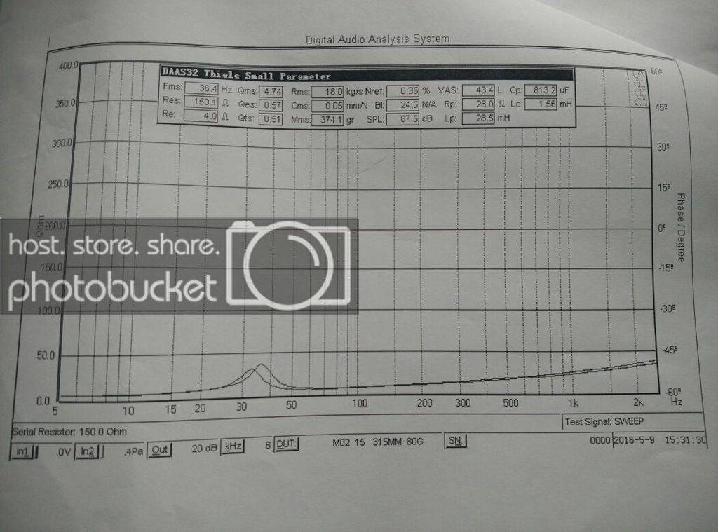

20160602_202722_zps3pgisbs8.jpg'%20alt='20160602_202722_zps3pgisbs8.jpg'>
