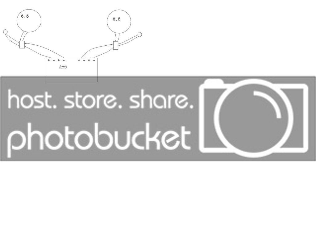

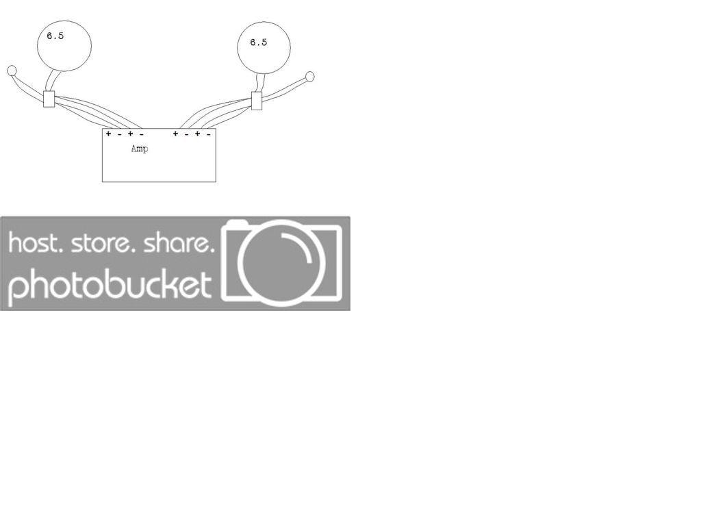

i have a set of pg rsds. Would i be able to use 2 channels of a 4 channel amp to the left side and the other 2 to power the other side?
Like if i use a 50 x 4 amp, could i be able to wire 2 channels together to get 100 watts to each speaker. And to make the amp think i have 4 speakers instead of 2?
Yes, As long as the amp is bridgeable you can do that. But to make it simple. Just take the positive from one channel and the negative from that other. You do not need 4 wires per speaker set...just a positive and negative.
it wont work, you cannot run your speakers at 2 ohms with the crossovers, if there are 2 4 ohm speakers hooked up to a crossover the amp still see's a 4 ohm load, unlike if there wasnt a crossover. if you run it like your diagram (which by the way the crossover to the amp will only have 2 wires not 4) both sides will see 100 watts a piece
