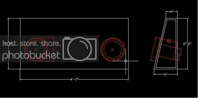

took about 5 minutes and with your overall dimensions came up with a simple box. I'm assuming that the 10-12" measurement for depth is at the bottom of the seat. They usually taper back so I used 6" at the top which even then may be quite too much at 26" high. But this setup gives you about 5 cubes before sub displacement and assuming 3/4" wood. and over 8" of mounting depth (which could be increased slightly, or less depending on the size of the magnet on the sub) So you are most likely not limited to shallow mount subs, doesn't mean you can't use em, and I hear good things about those kickers.

What is the possibility of mounting three shallow mounted Kicker CompVT's in the box and what would be an idea amplifier and wiring setup to make sure the subwoofer get the maximum amount of power they would need?

Ok I re-measured it a bit with the seat pulled up to a slightly comfortable position(Not too far up) and its currently 55"L x 26"H x 16"Bottom Depth and 8" Top Depth, so the length between the bottom of the seat and the top of the seat slowly decreases in depth.
