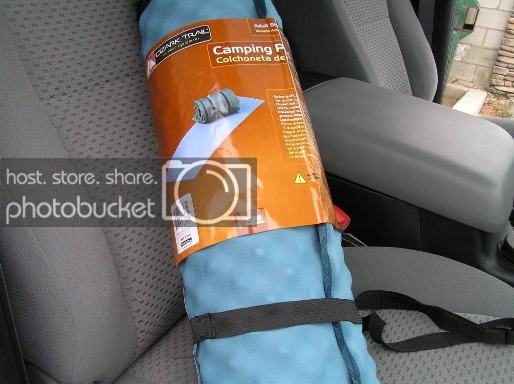

Closed Cell Foam from Home Depot....
I am on my way to Home Depot to check out the closed cell foam. If it will be easy to apply it might be a cost efficient waterproof foam we can easily get our hands on. //content.invisioncic.com/y282845/emoticons/eek.gif.771b7a90cf45cabdc554ff1121c21c4a.gif
Also I still have a bit left if you want some.
I did under my door panels and carpet with the exact same stuff but mine came on a roll.
how much did you pay for that roll?
and where
No, I got it from my work. They gave me what was left of a roll they were finished with.
I'll try and get some info on where it came from and how much it was when I go in tomorrow.
P.S. The ones they buy are 4ft x 250ft so I'll make sure to get a quote on some small rolls if I can
No, I got it from my work. They gave me what was left of a roll they were finished with.I try and get some info on where it came from and how much it was when I go in tomorrow.
P.S. The ones they buy are 4ft x 250ft so I'll make sure to get a quote on some smaller rolls if I can
awesome
i have the same foam , i bought two rolls for my doors as that is my next project i think i got 2 yards for about 16 bucks or so , its cheap but i hear it works really well.
So maybe I will check out the walmart egg crate. I am tackling the deadening of my doors this Sunday and I dont have time to wait for anything but home depot and wal mart are close enough by me.
Back in the day, I used that ^^^ exact waterproof padding behind the drivers in my doors. The only way it works is by diffusing the rearwave of the speaker only at certain frequencies (it's not broadband). Basically, the frequencies wavelengths must be higher than 1/4 of the distance between peak and trough of the dimples of the foam. In other words, if that distance is 1/2", then the wavelength can be no greater than 2". As an estimation, you're looking at full diffusion at about 6.7khz and above. No midrange that I know of will play that high.
If you do hear a difference before and after installing something like that, what's most likely happening is that you've diffused the upper harmonics (3rd, 4th order) in the back wave. This will only happen if you have not put that driver on a proper baffle. So, in reality, it's a band aid.
Since closed cell foam in general has low porosity (the camping pad is waterproof) it will not absorb sound waves (nor will it absorb water).
The moral of the story is to save your $12 and your time and invest both into making a proper baffle for the speaker, instead. A proper baffle is not a generic speaker ring; it should properly separate the front wave from the rear wave and effectively convert the rear wave to heat.
Since I absolutely hate MDF with a passion, my suggestion is to use something dense, rigid and durable for the environment. HDPE (aka cutting board plastic) is probabably the easiest to find in multiple thicknessess and the easiest to work with. It's way more dense than MDF and will serve to be a better baffle material in the long run.
The PSA-backed foam in the OP is best used as a gasket to mechanically isolate two surfaces from each other where rattling occurs. But, again you can save your money and just buy some weather stripping, IMHO.
