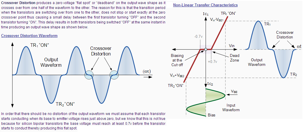

Other differences that can be heard are better related to poorly designed circuits that suffer from large amounts of crossover distortion. This happens when the hand-off from one transistor turning off to another turning on is not matched very well. Put as pure a signal as you want into one of these amplifiers and all you will get out is garbage. This can affect the sweetness of the treble and all but kill the life brass and wooden instruments. You will hear that.
crossover-distortion-png.56816
