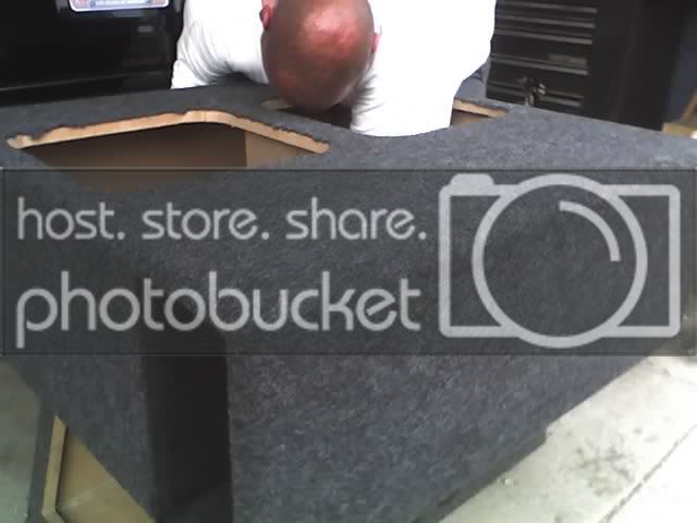

Just some pics of what I did after lunch today @ work...
Simple Custom Ported Enclosure for 2 Kicker L715's, in an older style Chrysler 300M.
It's 6.6cubes NET @35hz with ~70 square inches of port. Only a Kicker 1200.1 on them, could go plenty more power. It bangs.

Box = ***. That port doesn't make a turn, does it
Indeeds //content.invisioncic.com/y282845/emoticons/wink.gif.608e3ea05f1a9f98611af0861652f8fb.gif.
Port is straight, no turn. All the edges are 45'd for sexiness.

nice build, get some more power put on those subs
Indeed, told the customer to get something ~1800rms and notice a gain! //content.invisioncic.com/y282845/emoticons/wink.gif.608e3ea05f1a9f98611af0861652f8fb.gif
He was very happy with the build //content.invisioncic.com/y282845/emoticons/biggrin.gif.d71a5d36fcbab170f2364c9f2e3946cb.gif.
