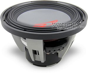

Alpine type R's....Less money, less required power, better sound....More win
http://sonicelectronix.com/item_6415_Alpine+SPS-69C2.html
The amp you run them off will determine what voice coil configuration you get.
It should also be noted that these subs will handle more than 500RMS and beg for more so dont worry about over powering them. (within reason of course)
You need to evaluate what your goals are for your setup so you can pick what you want. I can tell you that you are going to have to sacrifice an arm and a leg to get anything that will run those Pioneer subs well. If you get the Type R's I think you will be VERY satisfied with them and you wont spend as much.
