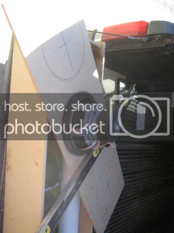

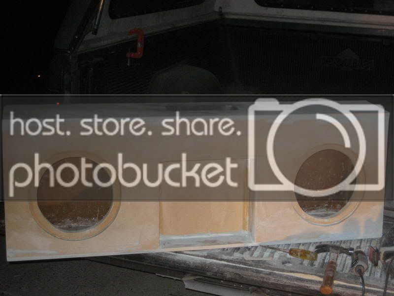

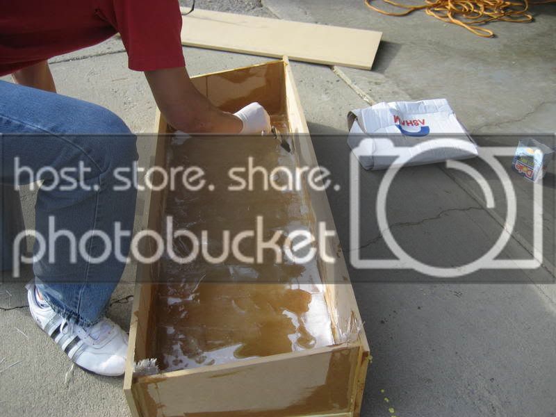

this is the box im building for two 10" type s' and and av12 amp

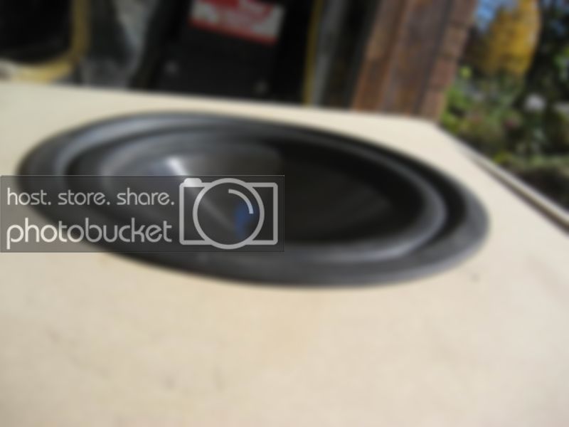

the amp will be recessed into the box and the subs will be countersunk. Its going intio a chev 1500 regular cab. it will be about 2.6@35 hz

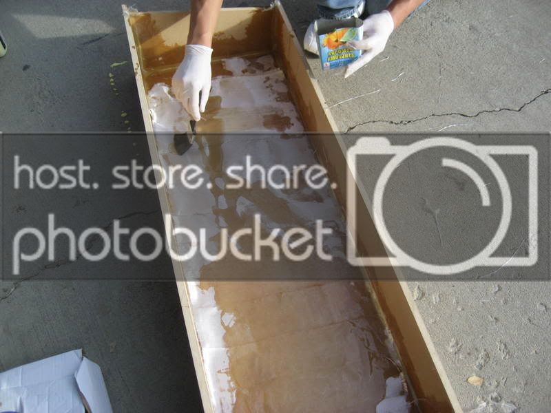

yes its made from 1/2 mdf to save some space...but since its glassed it should be more than fine //content.invisioncic.com/y282845/emoticons/wink.gif.608e3ea05f1a9f98611af0861652f8fb.gif
How do you save space over 3/4" when you're adding at least an 1/8" or more of glass inside the box and taking up volume?
Couldn't you have just used 3/4" and shrunk the box 1/8" all around?
could have yes...but he wants it ported and i wanted the most volume possible. its not a huge saving in volume but the box is going to be very strong aswell.

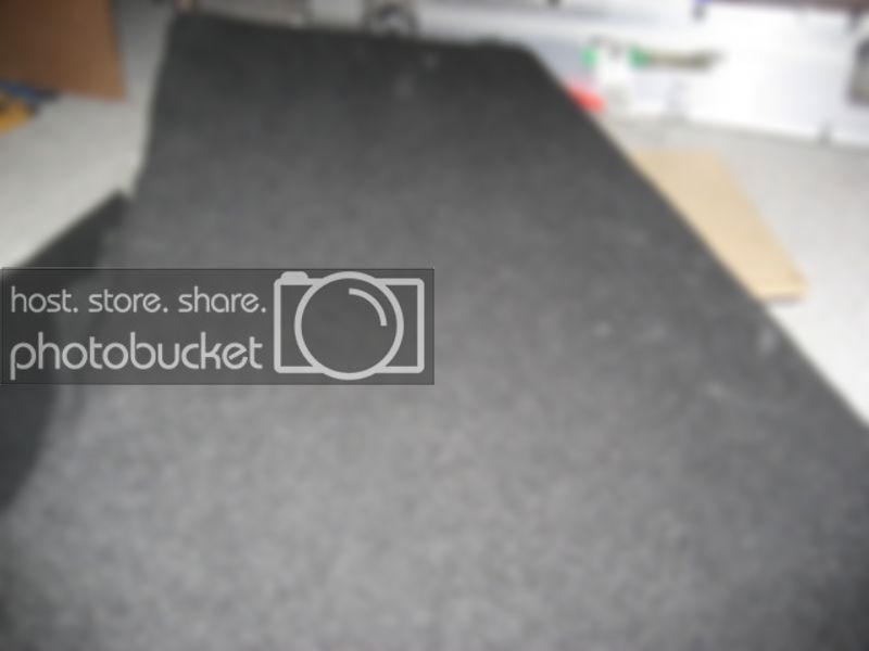

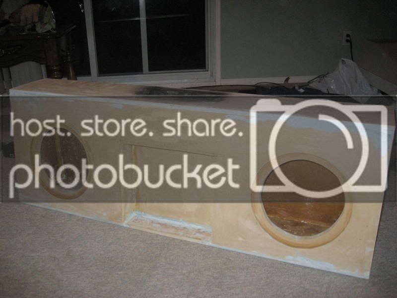

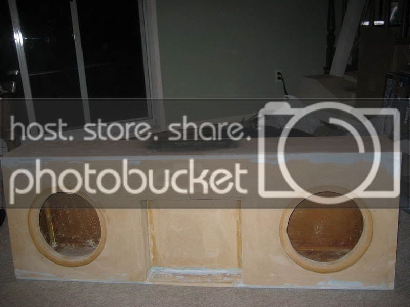

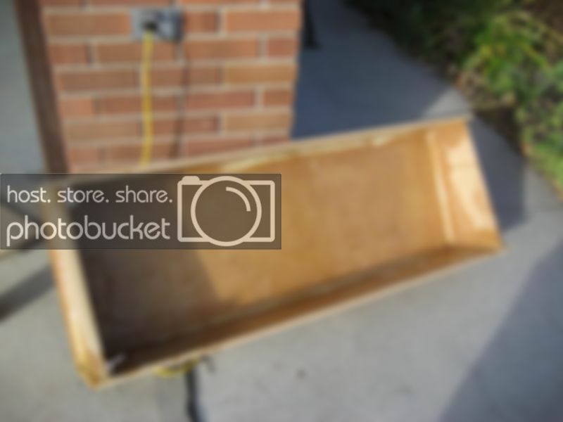

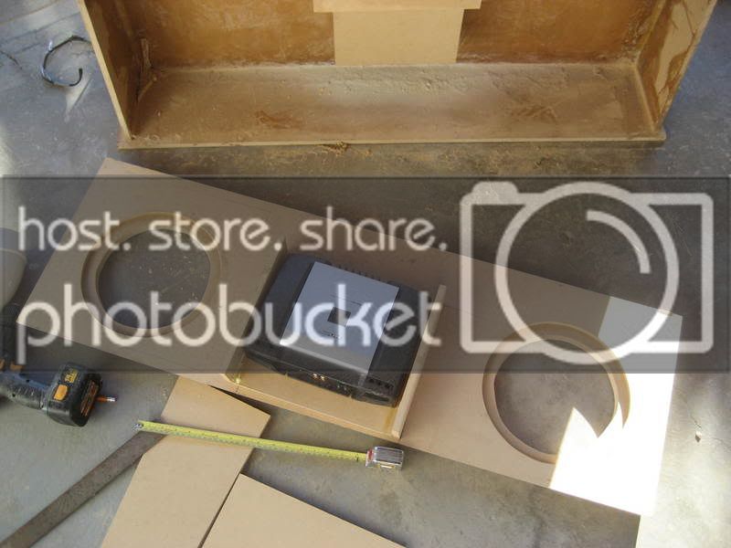

well i worked all day on it and got it done with. I am very happy with how it came out. i just have to finish carpeting it now... ill have those pics up after

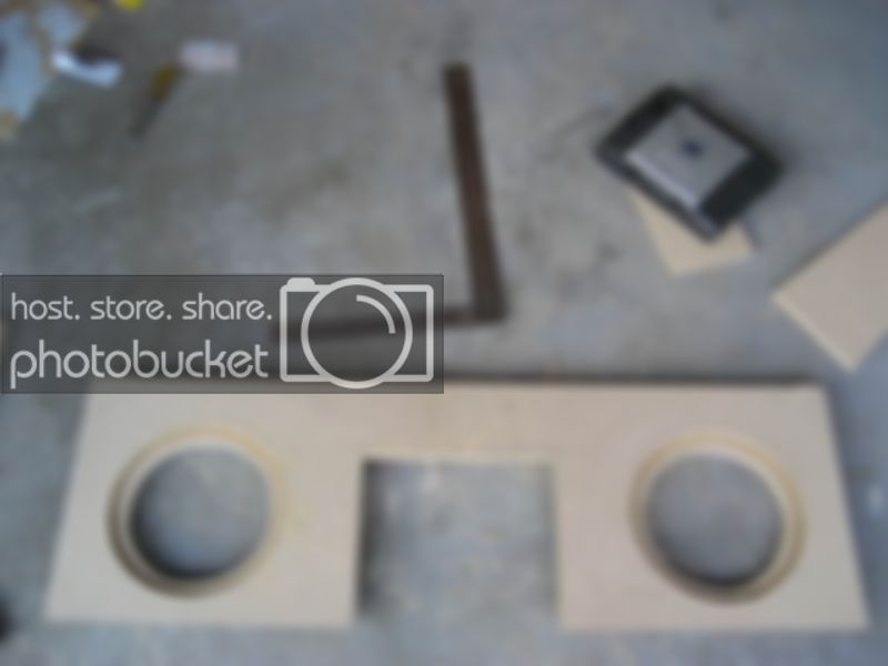

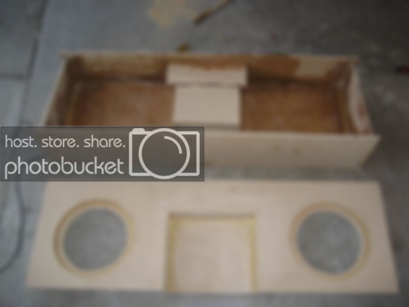

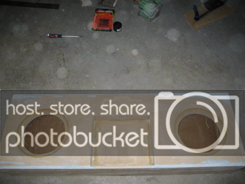

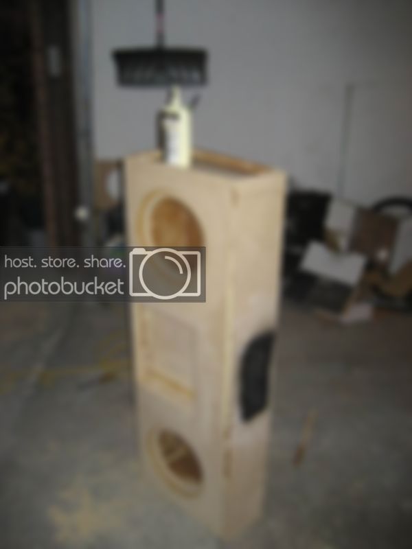

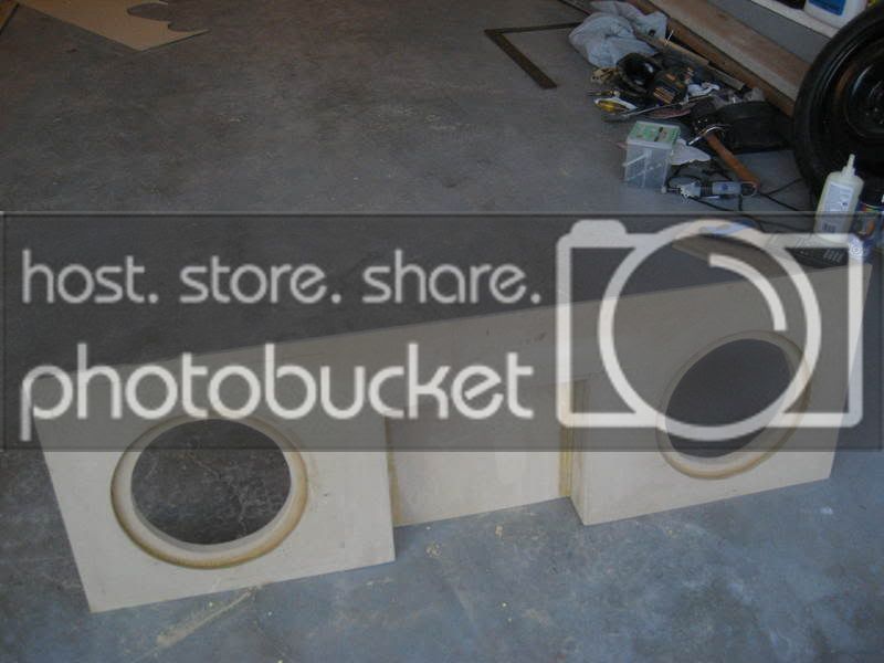

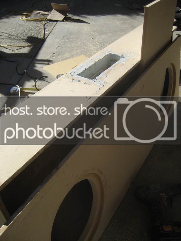

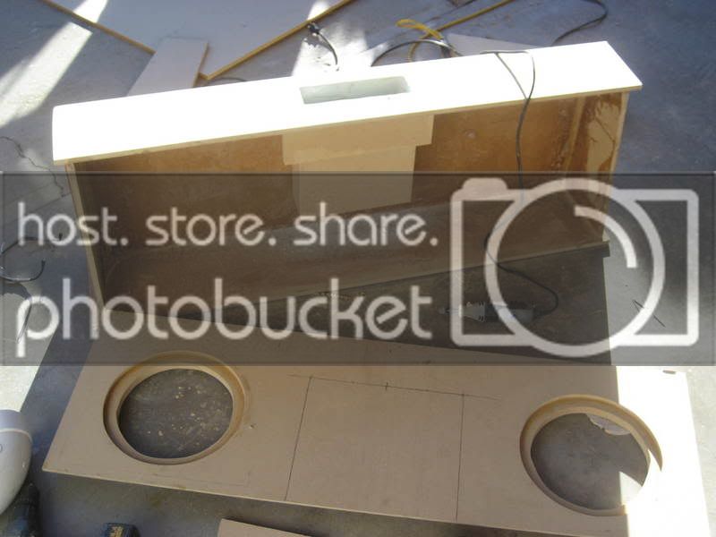

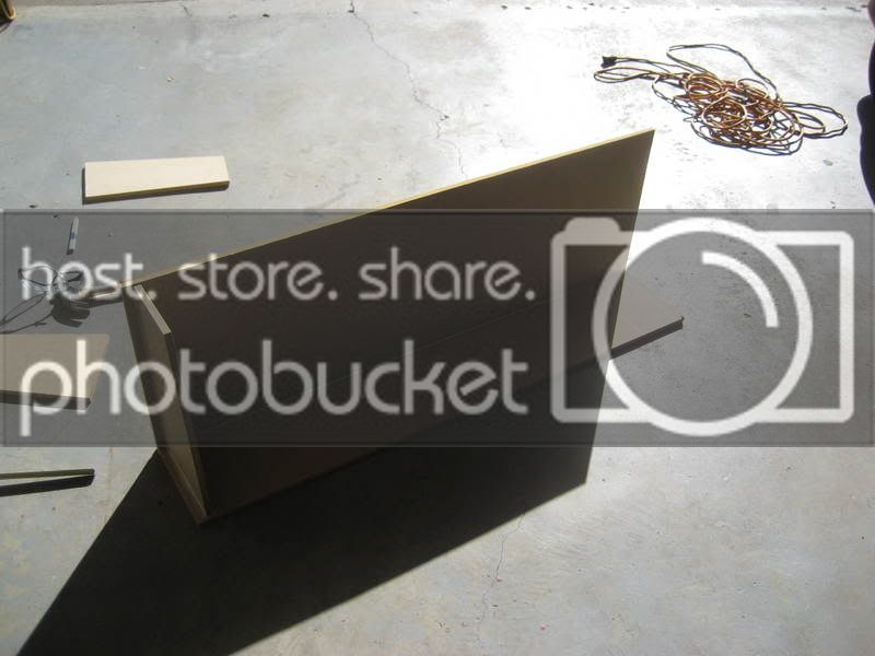

top and bottom peices complete...

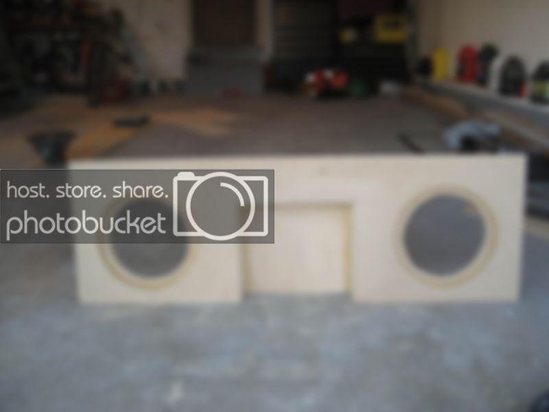

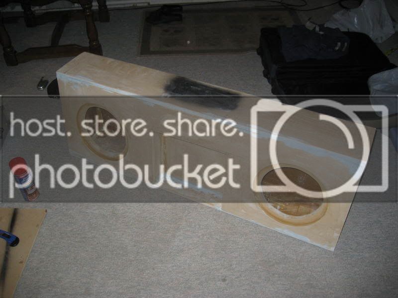

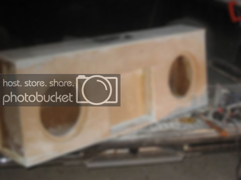

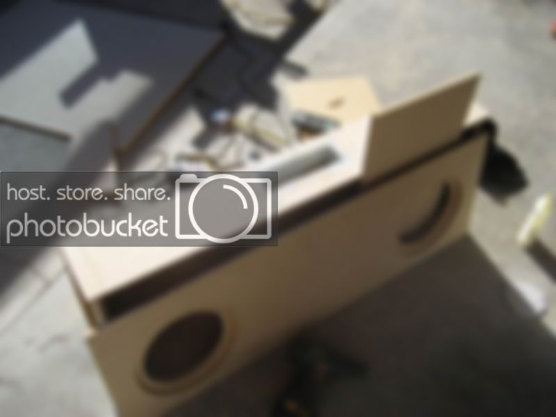

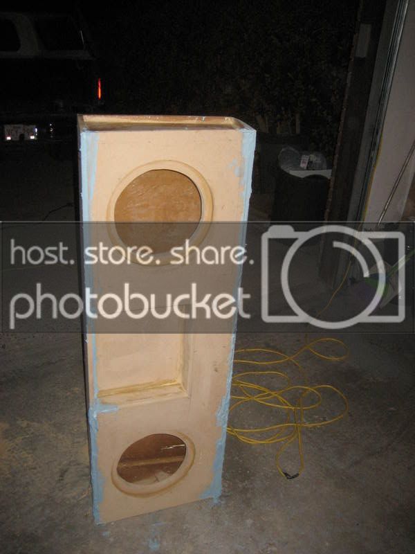

put together

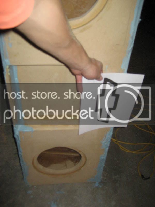

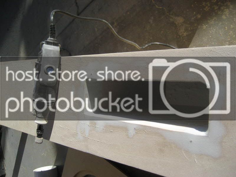

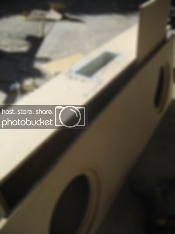

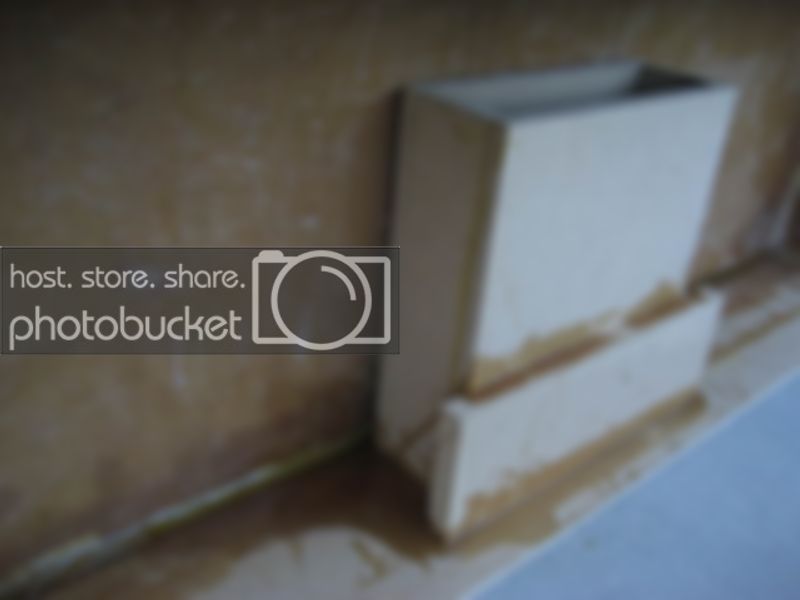

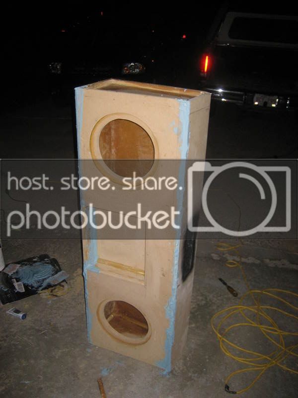

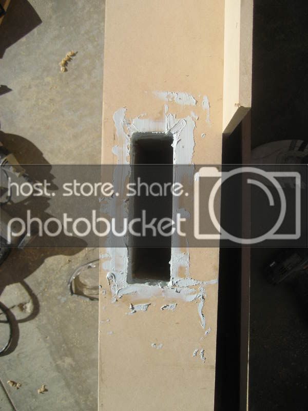

bondo on the corners to ensure that it is smooth and has a nice roundover

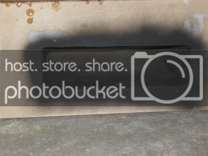

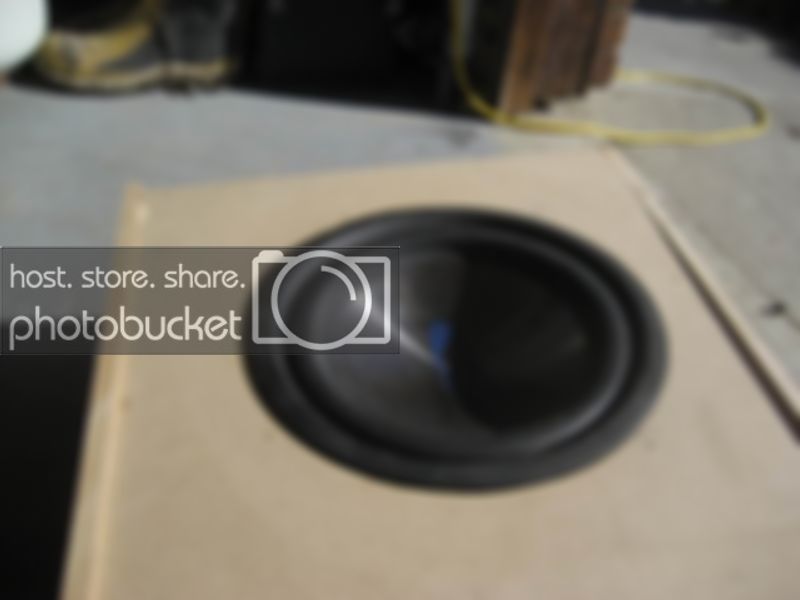

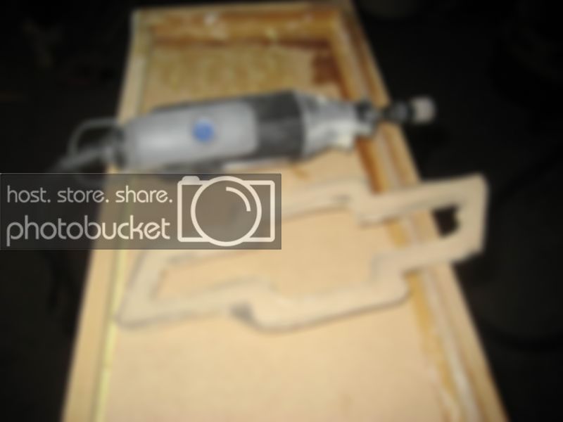

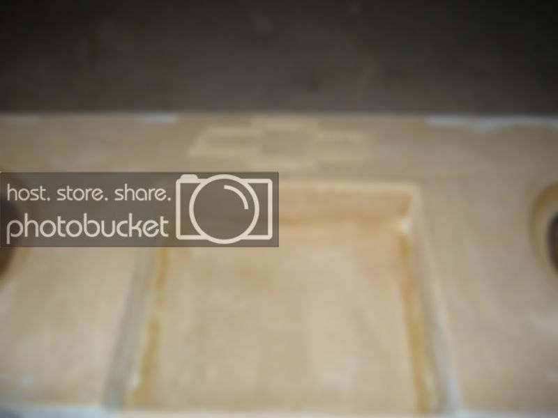

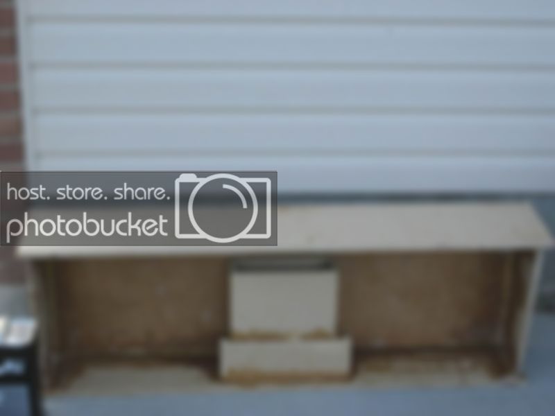

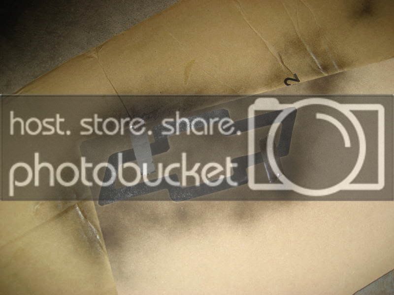

whats this...

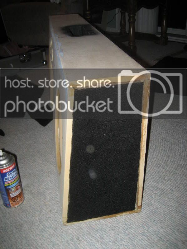

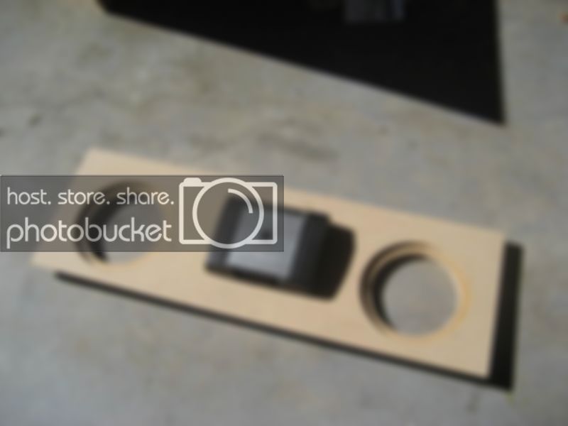

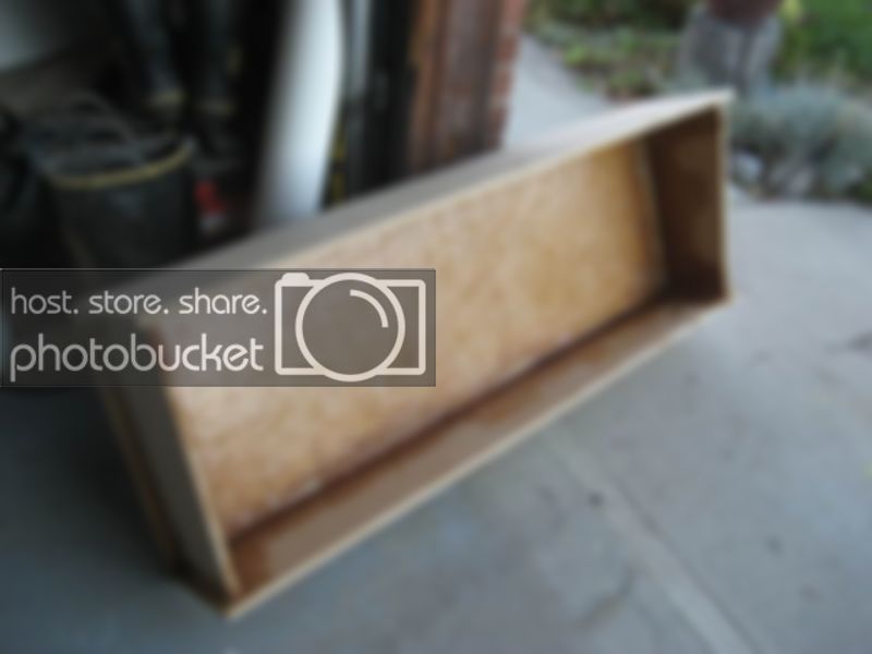

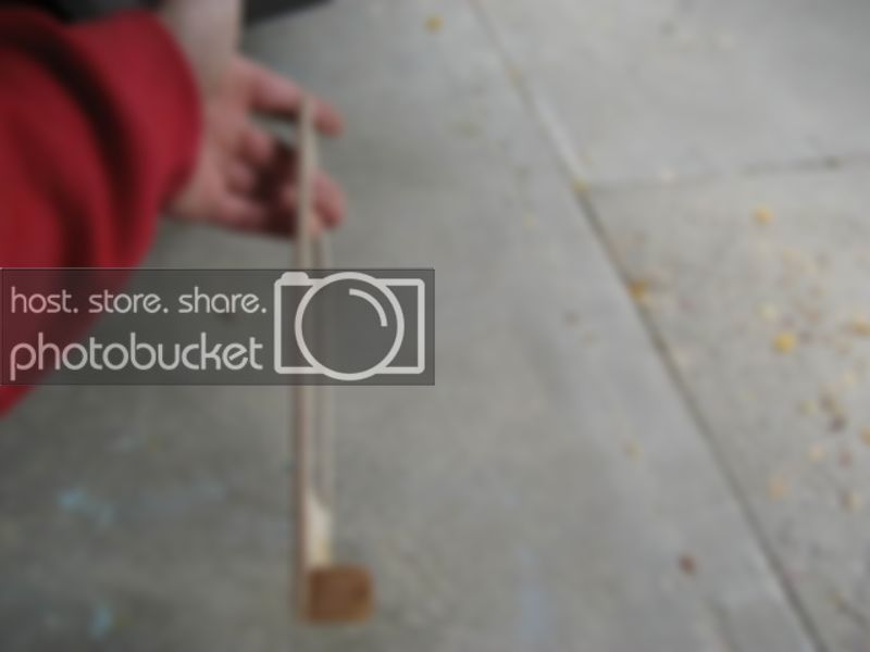

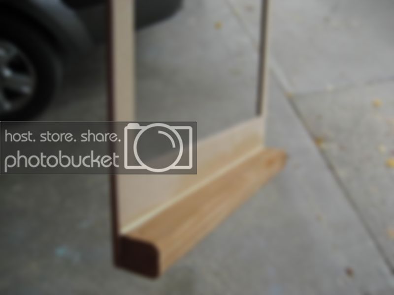

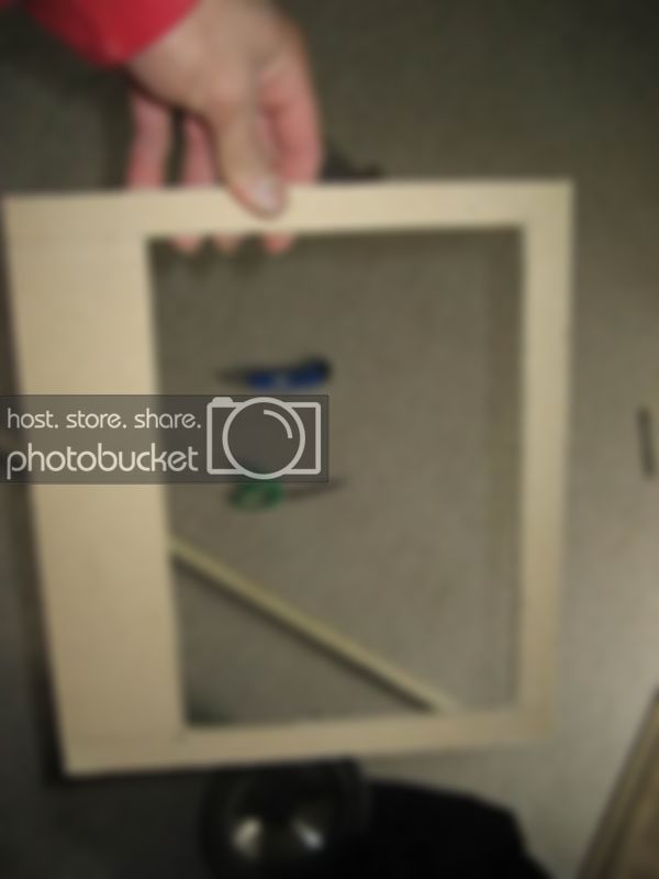

cut out and transfered to 1/4" hardboard

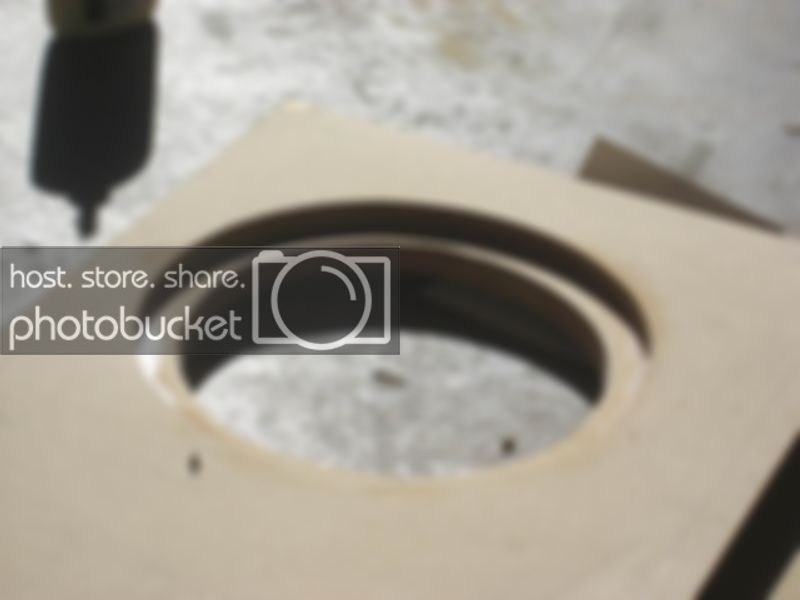

sanded
bow tie cut out

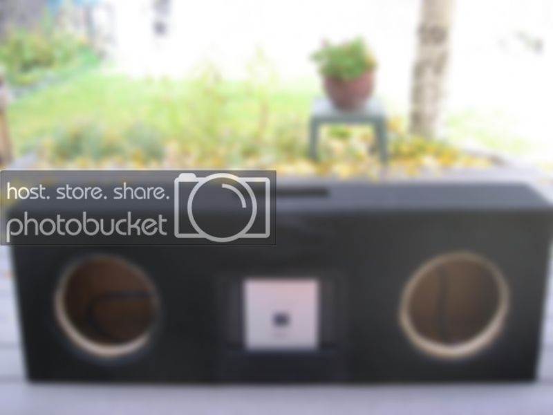

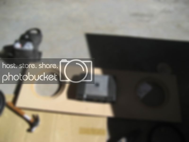

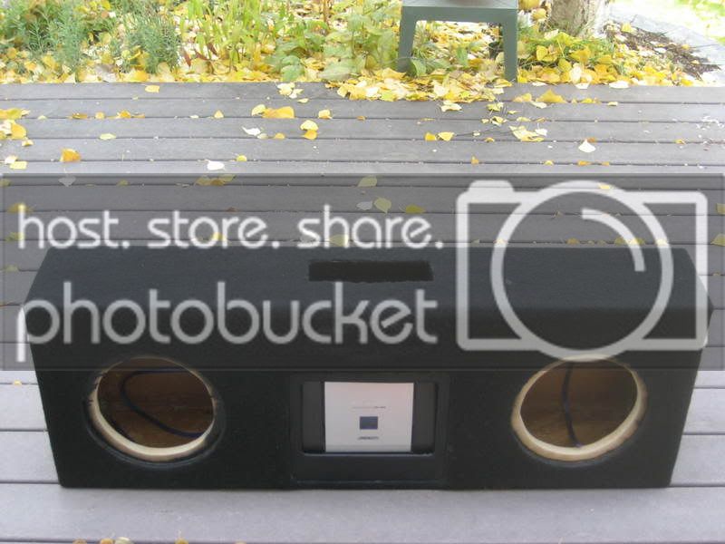

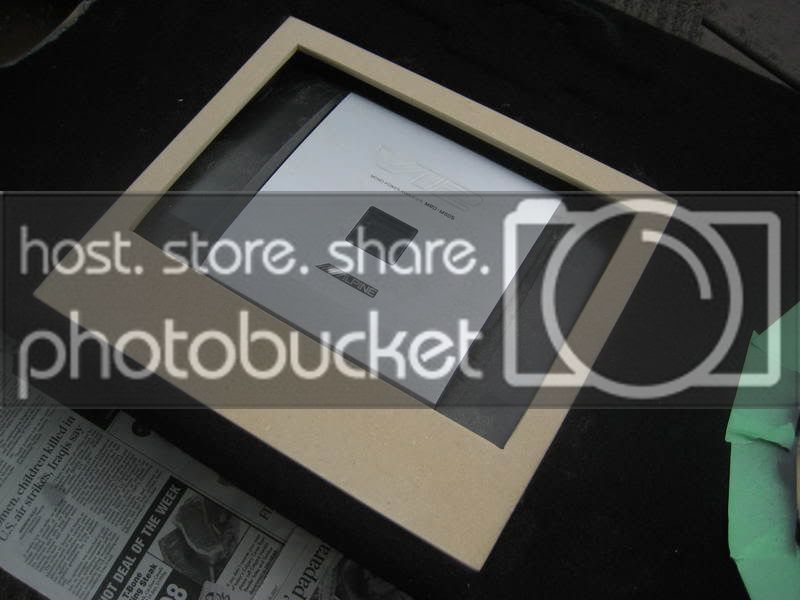

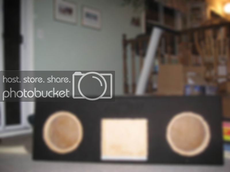

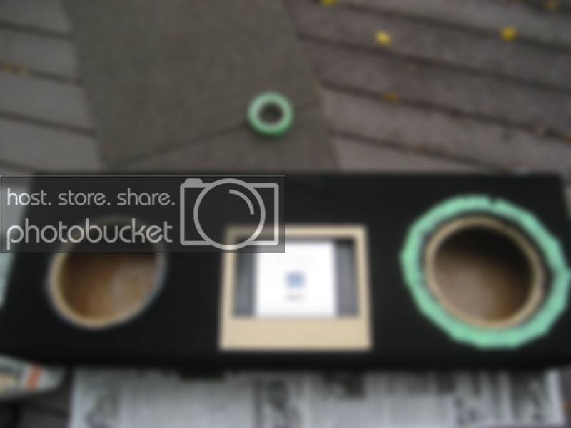

its 99.1% done...i just need to build a trim panel for the amp rack. It will be made from 1/4" hardboard and covered in black vinyl leather. i think it should contrast nicely. Its only going to cover the edge of the amp and the wires. here are the pics:

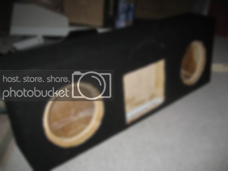

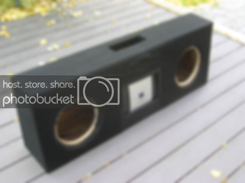

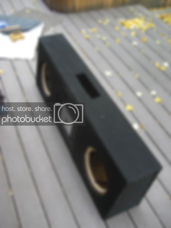

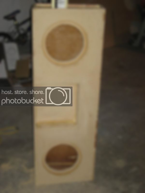

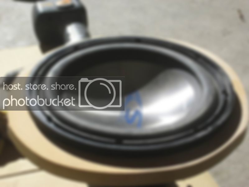

i finished and got it to the customer. He is very pleased with the result. hopefully i will get installed pics soon...

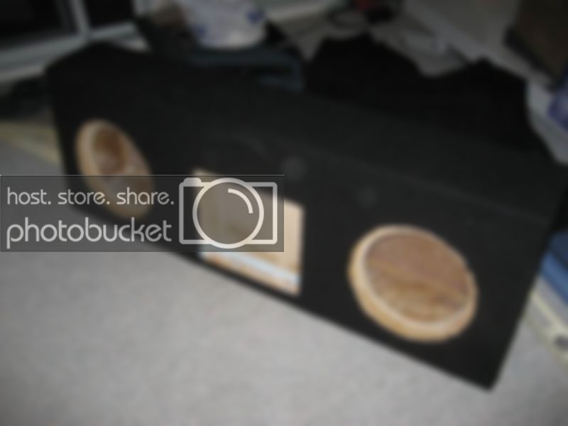

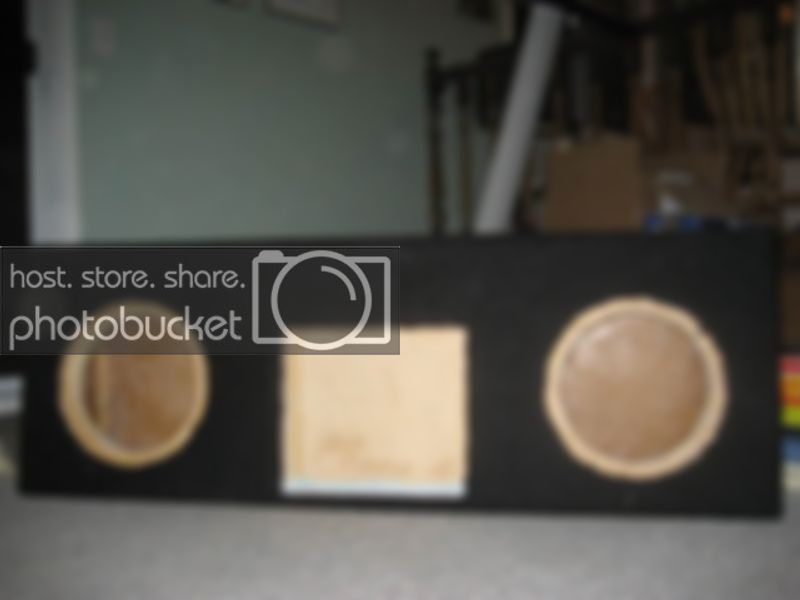

anyhow here are the finished pics
