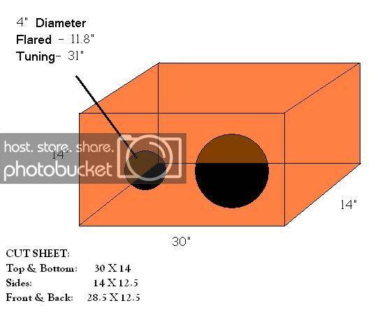

Check my box design please , PIX****
solidcrowd
About to make my cuts, but need to triple check before lol
Everything look good? Feel free to use my design if it's correct btw.
Volume is supose to = 2.58 cuft.
ALL INPUT WELCOME!!
no thats gross volume net is 2.50 before sub displacement also port area is a tad low try maybe 2 4" also also the port is too close to the back wall you want atleast port width distance from wall. maybe try to do ports on side of box
still gonna be close 1 4" aero in that airspace is around 5.02 per sqft usually with aeros u want like 9-11 per sq ft of port area whats your max dimentions you can work with i know you have more then 14" deep
