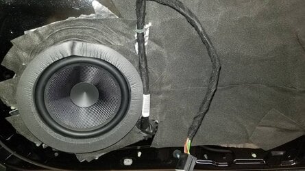

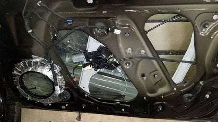

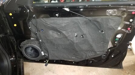

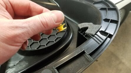

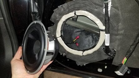

Agreed.  Closed cell weatherstripping foam is desired to gasket the new speaker to the door/adapter/panel.  It's only $3 for a 10' roll of weatherstripping foam at any hardware store and you can choose the thickness and width.  You want a thin gasket between the speaker and the plastic mounting adapter (can be foam or putty).  Then you want a soft, thick gasket between the speaker and the door panel. Be careful to not get any weatherstripping on the surround itself and do not use open cell foams.  A 2017 Malibu is pictured below.   I also added some foam at the door clips to minimize them from being audible.
