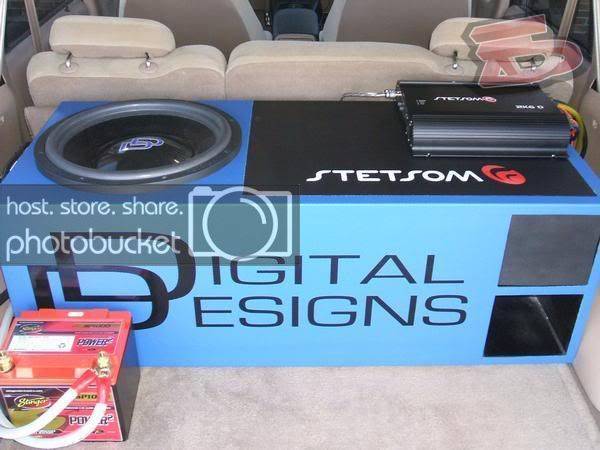

this is how im trying to do mine.. this was built locally by a shop who has since went out of business. with 1 port plugged, it sounded great and low daily.. pull the plug out and it meters awesome, i saw that setup do 149 legal and peak at 48hz in an Explorer.. it has never metered below a 148

current box
is 4.99cuft before port displacement.. port is 14.5h X 5.5w x 16.75d which equals 40hz on Carstereo and 43hz on 12v

36w X 14t X 17d external measurements = 34.5w X12.5t X 15.5d = 6684.375.
6684.375/1728 = 3.87 cuft
i'll be using a port separator that .75. the port height will be 12.5-.75= 11.75in . two ports so 11.75/2= 5.88ea port height
port area 5.88t X 6.5w X17.75L =678.405 /1728 = 0.39 port displacement per port .39x2 = .78cuft of displacement
3.87- .78= 3.09cuft after port displacement
i used this PORT Size Calculations and Formulas for WOOFER and Subwoofer BOXES
calculate your vent length
square port- YES slot port-YES
number of ports- 2
enclosure volume- 3.87
desired frequency- 45hz
port height- 5.87
port width- 6.5
LENGTH- 17.89
number of ports- 1
desired frequency- 32hz
port height- 5.87
port width- 6.5
LENGTH- 17.6
i figured it as plugging one port removes the port, and tried to find a common port length, which was 17.6in and 17.89. i figured tuning wouldnt wouldnt be affected to badly if i used an average of 17.75in length
You can't sue the same enclosure volume for both calculations because when you plug the end of one of the ports, the volume that that port normally occupies, now becomes part of the net volume.
Have you thought about doing two ports on separate sides, then plugging one for them? It's a good deal easier to work the numbers that way.
i thought it but i was scared that 2 separate ports would take up too much volume
how drastic will it affect tuning and volume. any chance that it will be negligable and little effect?
use winISD
i have no idea how, but i will tinker with it
im not super worried about the box volume. the DC will work fine in 2-3.5cuft. i just want the Tuning as close to 43-46hz and 32-34hz as possible
true, i have hella space back there
whats worst case scenerio, if i do the 2 ports 5.88t X 6.5w X 17.75L ? im sure box volume will be fine , but how drastically off are my calculations? its not like i HAVE to be pinpoint accurate, but i'd like to be at least 32-35hz 42-46hz range
