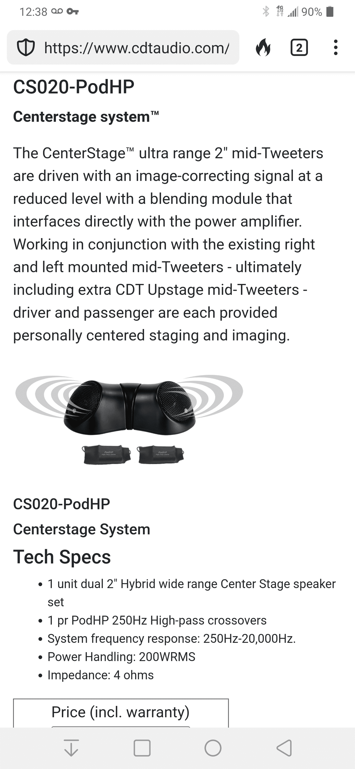

I think CDT makes a passive center channel add-on. It needs only left and right signal and it's x-overs do the rest.
Found it.
