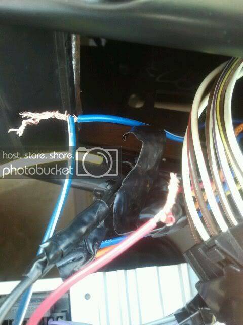

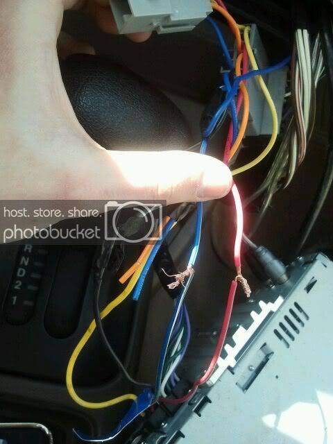

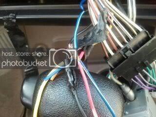

I also took some pictures of how it is all wired, if you could take a look and tell me if there is something obviously wrong, please let me know. Keep in my mind I was not the one who wired this deck in, was a buddy of mine.
First one is the Remote output wire and the red ignition switch wire spliced together, amp and head unit powers on when key is out of ignition.
Second is blue and white remote output wire from the head unit spliced directly to the blue remote wire that goes to the amp, amp powers on when car is off, head unit doesn't power on when car is off.
Third is just a closer up pic.

Man you should use these at least if your not going to solder and shrink wrap your wires....Your remot wire should be spliced into the blue/white wire coming out of the deck. If you still have juice when the decks off then its defective.
