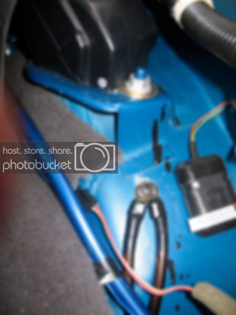

Well here is one question I guess to jump start this: Is this a good ground? It reads good. I tried only one other place as the ground needed to be in this general area and this one worked best:
I'm not sure where else to put it if I could though.
whats up fellow washingtonian.
First off, that ground could be improved. Sand a bigger area, on both sides of the metal. Also, use a bigger bolt w/ washers. You want that to be one hell of a solid connection. And, you can always get a can of blue spraypaint and just paint right over the top of that to make it blue again.

anyways, sand more area for that ground and use a much bigger bolt with washers. make sure your RCA's arent pinched or torn anywhere, check the voltages on the speaker outputs on the amp with a DMM to make sure your subs are getting the power you think they are.
