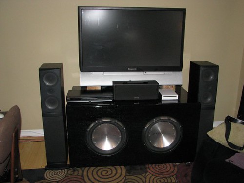

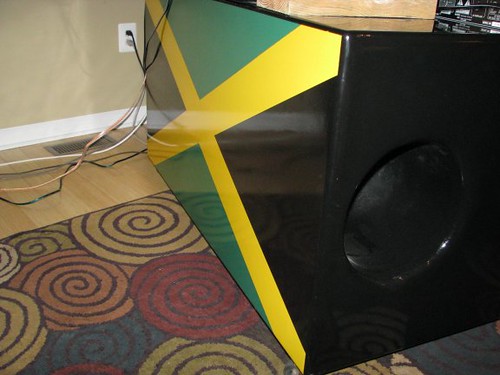

2 Rockford T1's when it was being powered by a QSC 1450 amplifier. I have them running off a Behringer EP2500 for now. You can find good deals on pro audio equipment on Craigslist all the time. Much easier than rigging power supplies and crossing your fingers. Wire the subs to the amp just like you would your car audio. I have these wired to 4ohm and the amp bridged mono to match.
